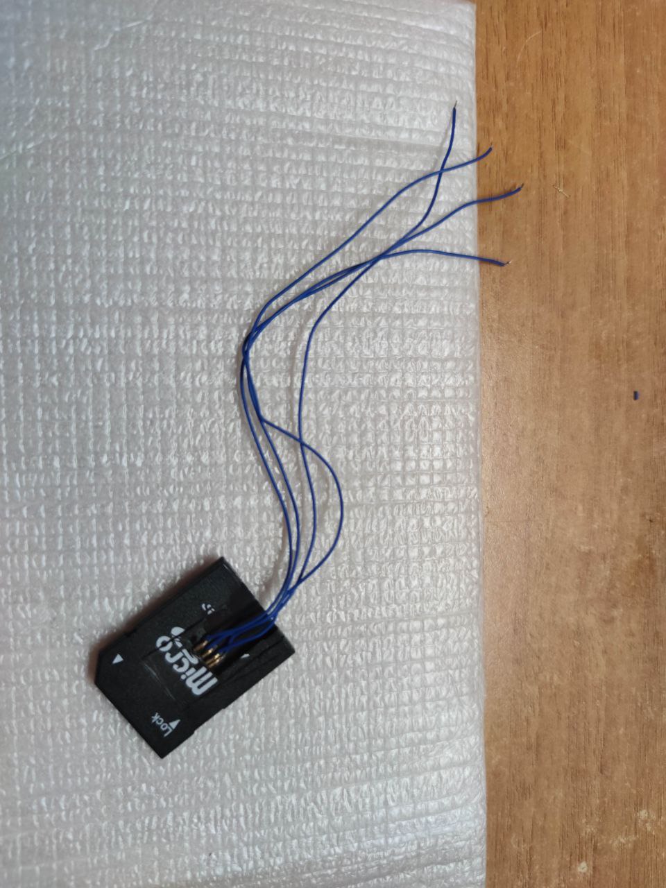

UPDATE: i wasnt able to boot with the x+start+select so i tried to enter into the bootrom error creating the fakesd card and it worked. entered the bootrom and booted b9s. currently restoring the image with ctrtrasfer on godmode9. thanks for the help guys ❤
UPDATE2: lol, just finished to restore the image but when i restart the console i got the same error:" unable to mount ctrnand or load the ctrnand firm", any suggestion?

Ok, i think we ( I ) have a problem: yesterday i was able to boot and everything else because i had still connected the fakesd adapter. Ive just removed it and the console acts weird again, no boot and black screen BUT now i dont need to force the shutdown by pressing the button but after few seconds she does it. if i press the start button and power on the console, the blue led light up for half a second and dies. even the ntrboot doesnt work anymore, just like before

What do you mean by fakesd adapter? I have a 3ds with the same problem but I'm having trouble following your posts and how you fixed it. You said something about entering into the bootrom in one of your other posts but I'm confused

You should create another thread but with fakesd i mean this *check image*, i know, its pretty crude but it worked :)

also on that SD where do you solder those wires to? It looks like people's old hard mod SD cards from back in the day

Ive followed only the first part on how to create the fakesd and the bootrom loading, then i proceeded as you told me, decrypt9 and so on
