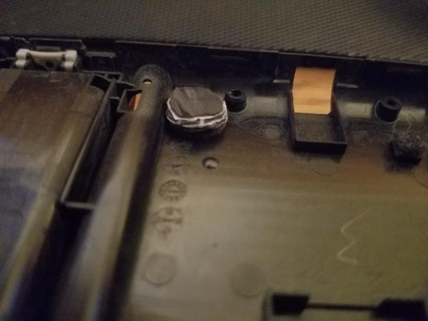

I am 99% sure it is the ZIF sockets, not the ribbon cables/sensors.
I had a similar problem when I disassembled mine with the non lifting zif near the bottom and not realizing it was simply a pull only. My solution was to take some felt stoppers with adhesive and stack them on top one another and top them with a piece of thin one sided adhesive rubber on the casing so that it would push down enough pressure on the zif when I closed the system when I couldn't get the paper wedge method to work. That way if I ever need to open it again I can do so.
Yeah that's the issue. Mine sending pictures of your fix?
Sorry was a bit busy, but here's what I did. I used some door rubber strip weather sealing and just basically cut it into small squares and removed the loop to make it a flat piece of rubber. Then stacked up on the felt stopper testing the right length until it would reach and put pressure onto the the part. Not the best looking fix, but it works for me.
