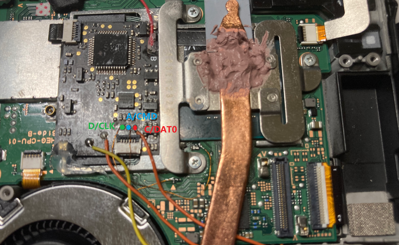

Long story short I ordered the OLED special chip (without USB header, locked) by mistake, and was a bit worried about it being unstable. Turns out it's way better than I expected. It glitches and boots instantly every single time (purple LED flashes 3-5 times and it's done). My only complaint is the QSB for point A and D are a bit off, doesn't align properly so I had to solder jumper wires to these points (see photo for details). It would be great if they also expose point A, C and D on pcb so you can solder to them directly.

My installation picture:
As you can see I used some jumper wire to solder to those pads on QSB, also the part extends to 3.3v and gnd points is a bit too long and arches up.
I ended up throwing away the metal shield for soc and ram chips cause I wrapped it so bad during teardown and I can't even flatten it. Besides I think direct contact from heatpipe to the die also helps cooling. If anyone know how to remove the EMI shield please let me know. I still have another oled switch waiting to be modded lol.
And success! Instant boot baby.

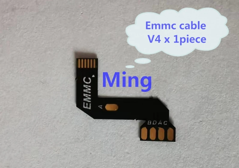

Had a few failed boot attempts today, LED flashes purple for like 10 times then turns red. Measuring with multimeter shows point D voltage drop decreased to about 100mV (nominal value should be around 700mV according to installation video on youtube). I think QSB is causing this problem so I decided to remove it. Turns out point A C and D are actually exposed on the modchip, just not labelled. Here are soldering pads for point A C and D (figured out the pinout myself with multimeter), they are right next to the ribbon connector.
No need to purchase the special breakout ribbon cable, just solder to the modchip directly.
Official-Ming-Hwfly-Core-Lite-Oled-chip-cable-set-accessories-no-include-the-chip-itself-wholesale.jpg_Q90.jpg_.webp
