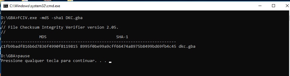

What's the md5 hash of Donkey Kong Country? Do you have the same problem with Clean Boot? Have you tried cleaning the nds/ez omega contacts?
Reactions: *ka

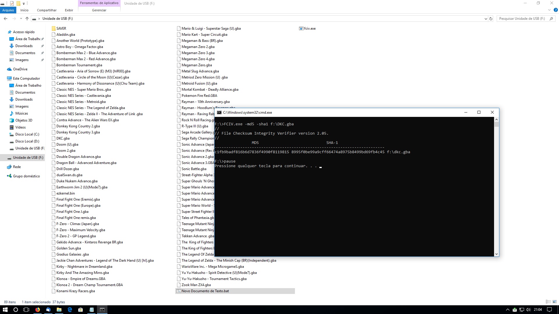

Yes this problem occurs in clean boot. Yes, I cleaned the contacts. I have to check the md5 of the rom, however that same problem occurs with other games, and the same roms normally work in ez flash 3in1 and omega freeze.
MD5 rom DKC
MD5: 9a3db7e1fe781945df44eb6be8713567 _ SHA-1: 3a0fa85187aa7c20842abeb1a6cbc11b21131b2c - f:\Final Fight One J.gba
MD5: c1fb9badf816b6d7836f4990f8119815 _ SHA-1: 8995f0be99a9cff66474a8975b8499bd69fb4c45 - f:\Donkey Kong Country.gba
MD5: a1f160ee30ed36edea341a6f1c6a4efc _ SHA-1: b0a4d59447c8d7c321bea4dc7253b0f581129ede - f:\Donkey Kong Country 2.gba
Well, Donkey Kong Country checks out; you can of course google the other hashes to double check the rest. The only other idea off hand I can think of is to try the other half shell and see if it occurs with that. You can also try putting a small piece of paper on the back side of the board (opposite side of the contacts) to see if that'll push the contacts up a little to make better contact. If neither of these help, then I'd imagine that the cart is in some way defective.
