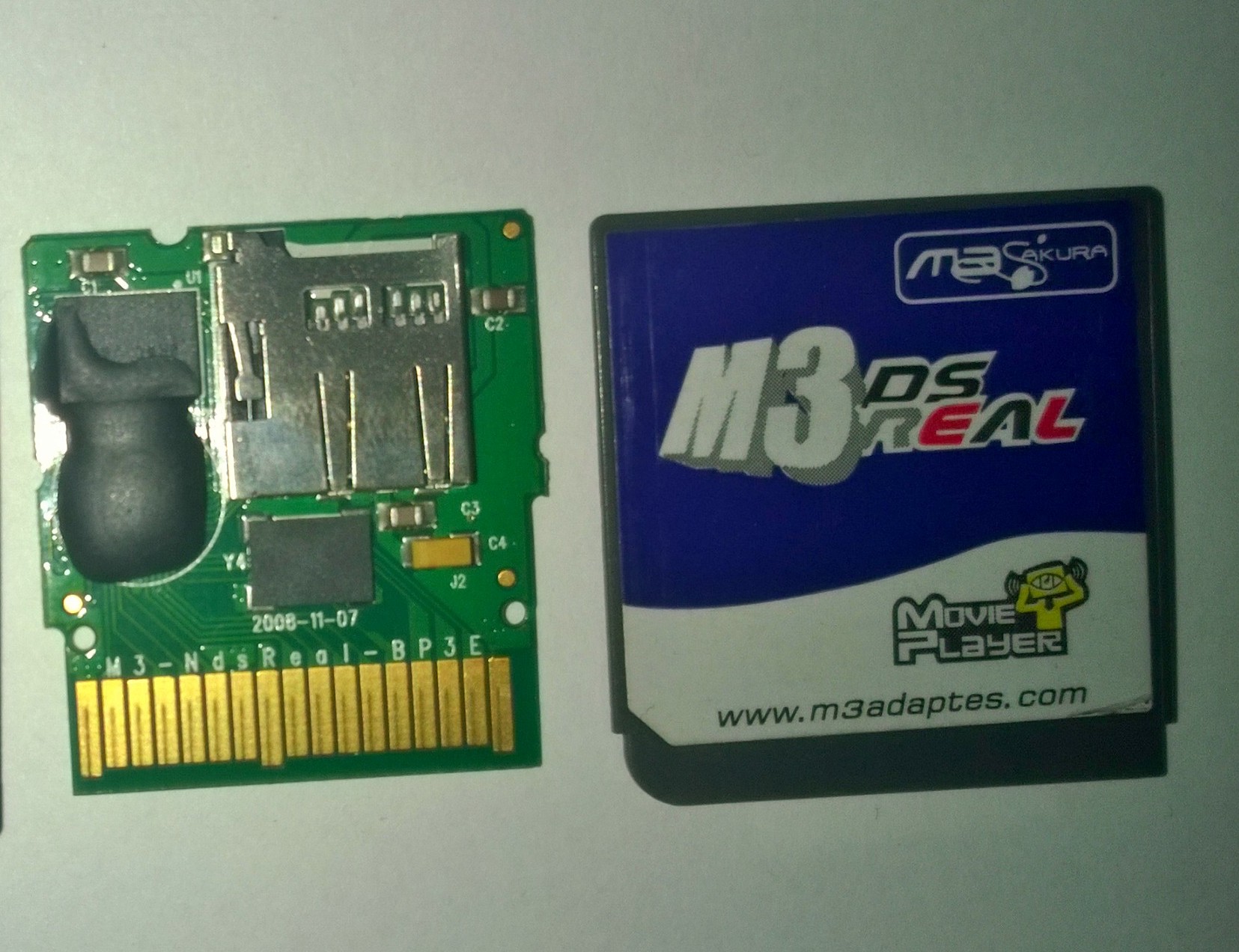

Just found this old card while clearing attic...It is a fake by the looks of the name at bottom of card...I have tried quite a few firmwares but just get the red card with menu icon each time.
Anybody know any firmware that will work with it?

This is a fake M3 DS Real, seems like it is using some DSTT based firmware.
Unfortunately I don't know exactly what it boots from.
You'll want YSMenu from here: https://gbatemp.net/threads/retrogamefan-updates-releases.267243
My guess is that it is using the `DSTTi-Clone YSMenu` folder, and you need to make a copy of TTMenu.dat and rename it to `M3i.dat`. I am not too certain.

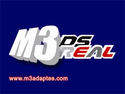

Update just got it working with this ( M3Adatptes English.zip 4.5 MB ) from linfox domain...thanks for help guys
Loading screen
Looks like I overshot a little... The boot file is m3.dat, with the same instructions for YSMenu as above.
