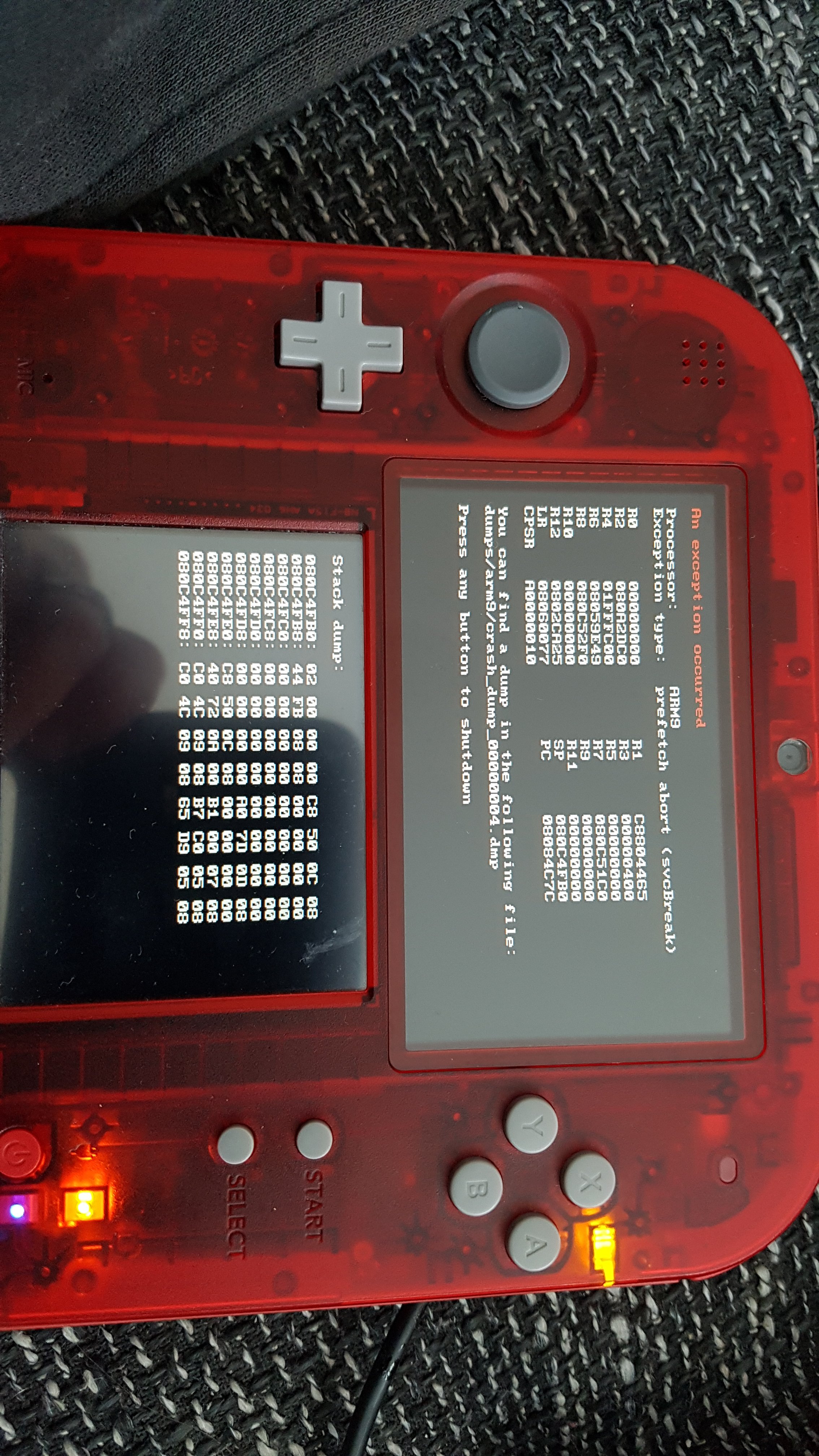

Hello there. my friend is having problem with his O3DSXL. He can get to luma settings, but when he clicks start to reboot, it shows this error (attachment):
Processor: ARM9
Exception type: prefetch abort (svcBreak)
First he was on luma 6.6 and A9LH. Now he is on B9S and luma 8.1.1
He can't boot to system (only luma settings and payloads)
What is he doing wrong?
Please help and thanks.
Edits:
Found this thread. Same problem: https://gbatemp.net/threads/help-cant-boot-after-9-2-0-ctrtransfer.478151/
After 11.5 CTR Tranfer still same error.
After 9.2 CTR Transfer still same error.
Recovery mode doesn't load and gives the same error.
older luma don't work.
Formatting and redownloading all don't work.
Asked homebrew discord. Nobody knows what the heck is wrong with it. Probably something with sysnand.

Did you check to see if there was a luma config in your nand? That could also be an issue. What settings have you selected in the luma screen? This sounds more like your fw is corrupted in some way :|
luma config is on sd (and on ctrnand). Selected are these:
Loading external FIRMs and modules
Enable game patching
Show NAND or user string....
Disable ARM11 exception handlers
When he fired it up first (luma 6.6 + A9LH) he had only Show NAND or user string...
Happy to see that it worked. Now let's find something that can help my friend :D
Replace the boot.firm in ctrnand with a newly downloaded one. Dont replace it with one you already have downloaded. Take your sd card out and see if it boots... Turn off everything in luma for now
