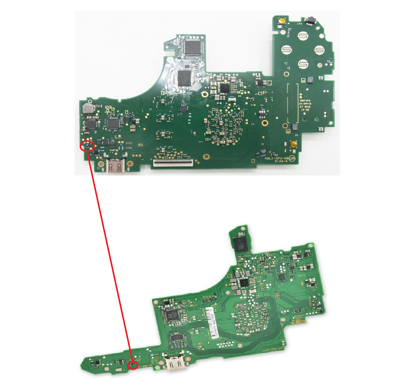

this little component here was crushed. a SOT-23 package.
is anyone able to supply me the value or numbers on it? or even a nice zoomed in photo of it?
It would be much appreciated.
It controls battery charging and should be a voltage regulator.

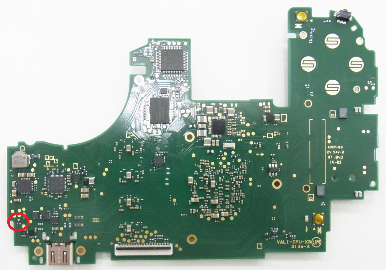

i was able to successfully find the replacement by poking around on regular Switch Console. i just swapped it and i have charge working. will point out part on switch board I used to replace, will perhaps help someone else in future. would be nice to find out what part # this is. #'s on it show 42. but doesn't mean much. i'll upload photo after full test.
here it is, be interesting to know if anyone could find a part # for it. #'s on the regulator are 42 with no other real markings that i can see. hope this helps someone one day if they are looking for it.
