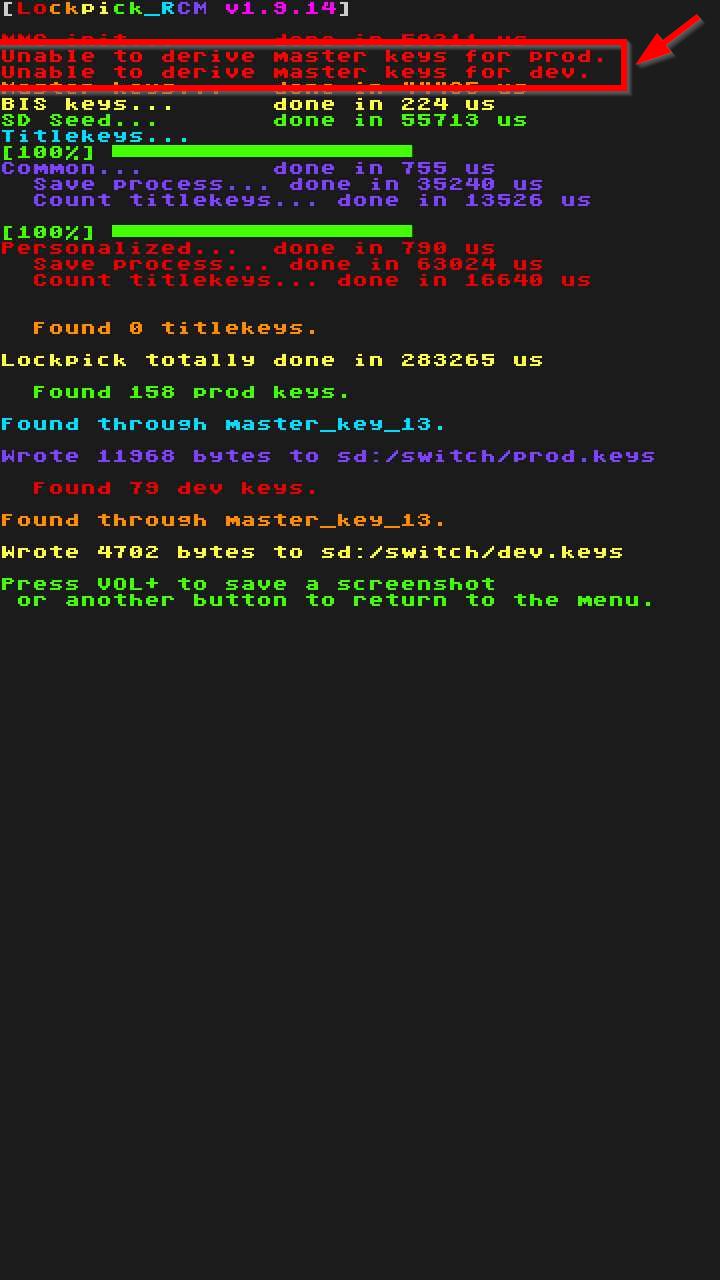

Voici la preuve que les clés de la sysMMC 20.0.0 ne sont pas lues correctement. Je les ai lues via une clé Erista v1.
I've got a Switch Lite, which is probably why I don't have any problems of my own.
I saw that 2 SciresM offsets had been corrected by borntohonk, if it's indeed a mistake I'd redo a version of LockPick_RCM with the right offsets that would work for Erista.
@Zoria Under Lockpick_RCM version 1.9.13, “233” keys were read out on my Erista with FW 19.0.1. If I see this correctly, and apart from the 13 keys generation under the new Lockpick_RCM version for FW 20.0.0 no other keys are read out, it should then be “242” keys.

Here is the proof that the keys from the 20.0.0 sysMMC are not being read properly. I have read them out via an Erista v1.
Yes, I used this as a basis for modifying LockPick, and I may have figured out what was wrong, but I'm still checking.

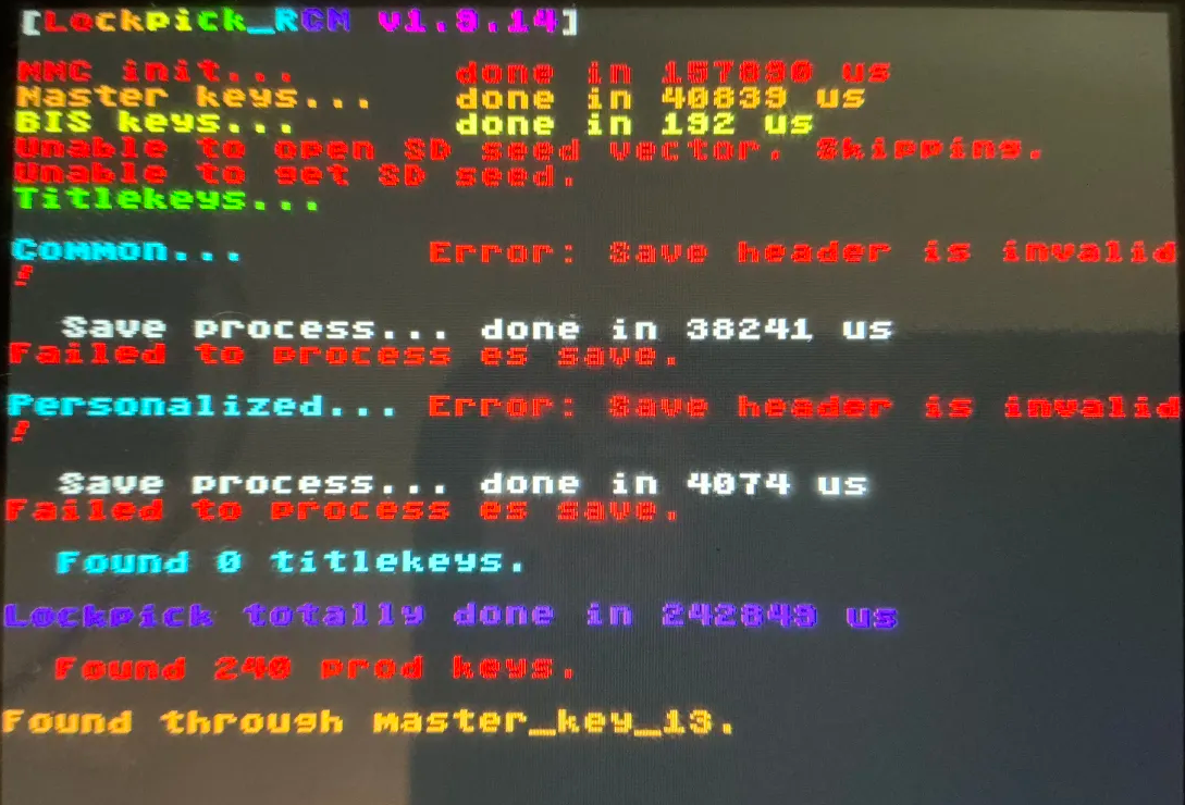

something is wrong, I compiled from the source code adding the new missing keys, I get the same result.
note 6 titles.
I calmly try to recheck for any errors even if I think I did everything correctly.
can the fact that Hekate is not updated compromise the reading of the new keys?

qualcosa non va, ho compilato dal codice sorgente aggiungendo le nuove chiavi mamcanti, ottengo lo stesso risultato.
nota 6 titoli.
Con calma cerco di ricontrollare eventuali errori anche se penso di aver fatto tutto correttamente.
il fatto che Hekate non sia aggiornato può compromettere la lettura delle nuove chiavi?
note 6 titles.
Yes on the post before yours is a code which is WIP and so far works on Erista consoles. We are waiting for Zoria comments about these changes. try the payload on the post before yours.

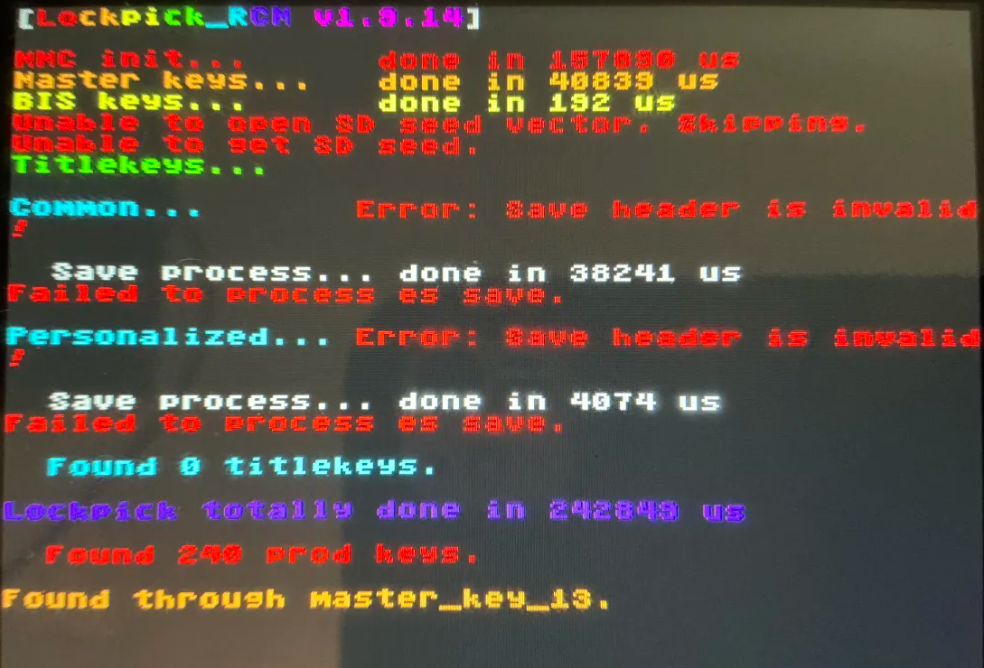

@impeeza Thanks for your modification! Apparently all keys are now read from the sysNand (Found 242 prod keys), but Lockpick freezes and can no longer be closed or exited.

Here is the screenshot of the frozen tool. On the second attempt, the Lockpick_RCM screen popped up briefly and was reloaded without anything happening.
In the end, the keys were not saved on the SD card either.
