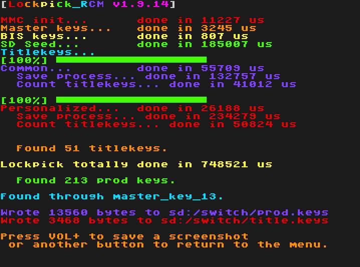

Usage
- Launch Lockpick_RCM.bin using your favorite payload injector or chainload from Hekate by placing it in /bootloader/payloads
- Upon completion, keys will be saved to /switch/prod.keys on SD
- If the console has Firmware 7.x, the /sept/ folder from Atmosphère or Kosmos release zip containing both sept-primary.bin and sept-secondary.enc must be present on SD or else only keyblob master key derivation is possible (ie. up to master_key_05 only)
