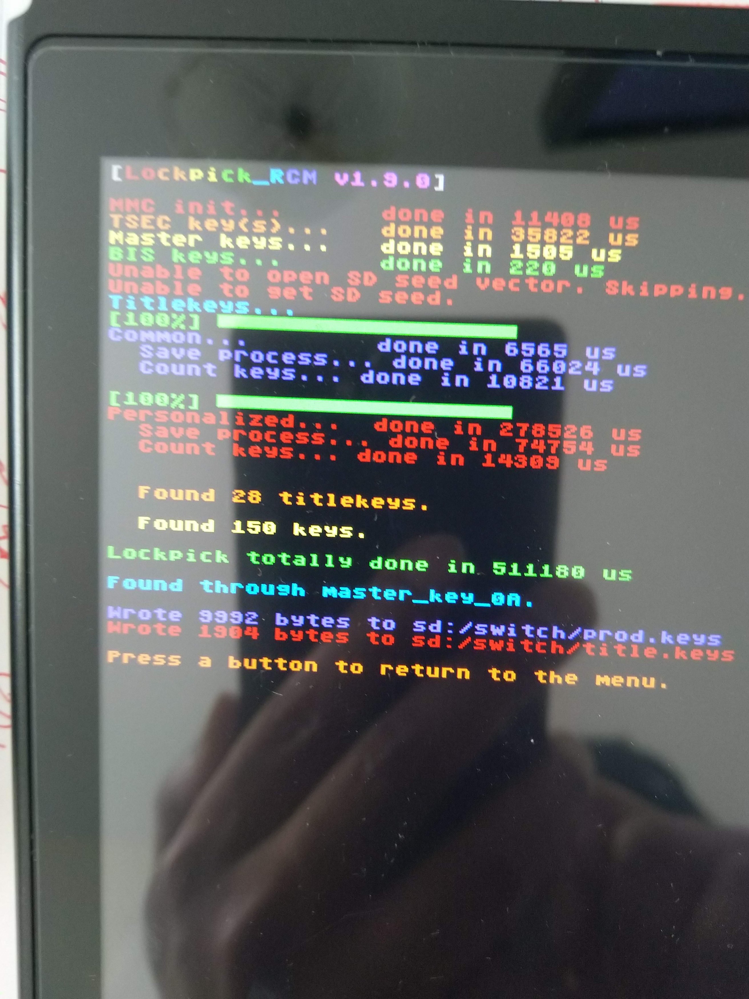

Hey Guys
i was following the switch hacking guide and dumped my keys with Lockpick_RCM.bin.
It completed but had a messages:
"Unable to open SD seed vector. Skipping."
"Unable to get SD seed."
I was not too sure what these errors mean and what i have to do about it

get a better faster SD card

you sd card is probably corrupted
Testing with H2testw, so slow using a USB2.0 adapter, gonna take 10 hours writing at 3.5mb/sec :O
My USB 3.0 adapter is just causing drive to disconnect every time it starts to do a check.
ok seems to be fake u can try another pc/laptop but i think its a fake sd.
u can try diskpart but be carefull!! if you dont know what to do with diskpart otherwise google :-)

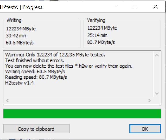

Thanks, the writing portion took 35 minutes, now the verifying portion is taking another 35 minutes
Edit, this is the result,:
I guess the card is ok, but will need to get a faster one
Warning: Only 122234 of 122235 MByte tested.
Test finished without errors.
You can now delete the test files *.h2w or verify them again.
Writing speed: 60.5 MByte/s
Reading speed: 80.7 MByte/s
H2testw v1.4

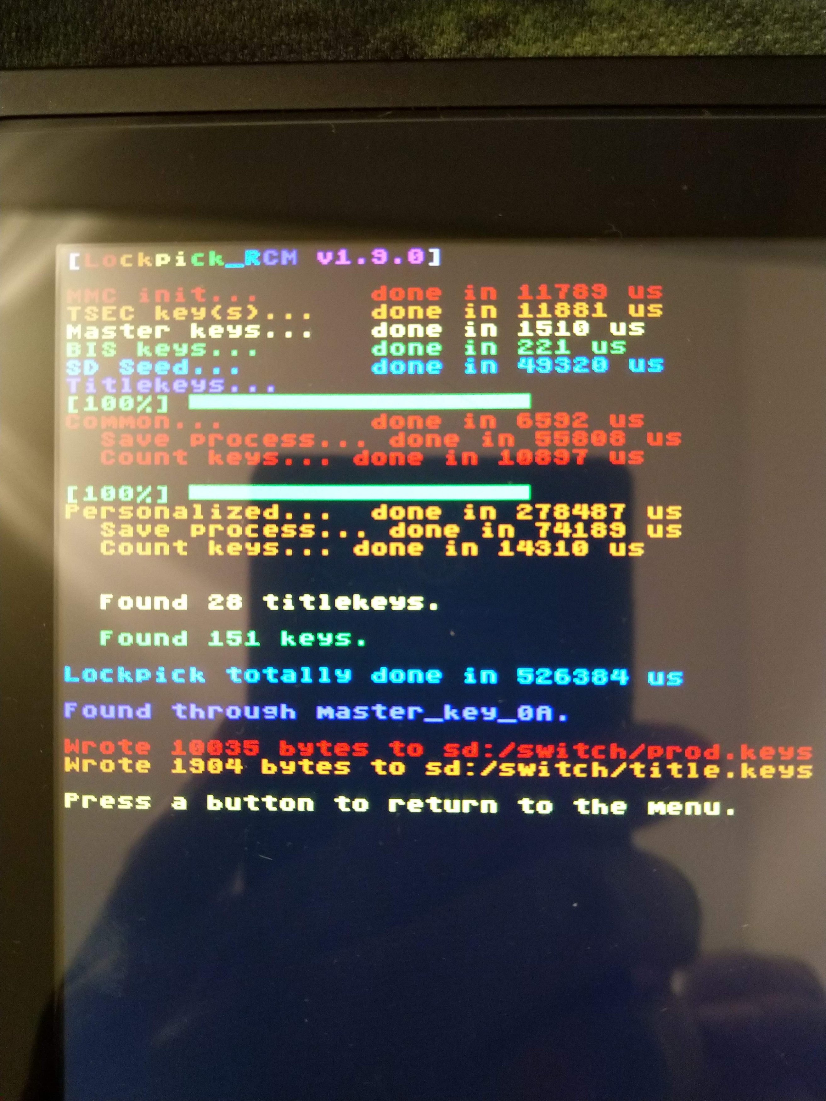

Thanks, ill format to Fat23.
I followed the advice in the thread below and ran chkdsk and it seemed to have fixed the issue
https://gbatemp.net/threads/lockpic...-latest-1-8-2-firm-9-0-1.564016/#post-9038172
I typed start>run>CMD>
"chkdsk H: /f /r /x"
If anyone is having issues as well
H is my usb drive
