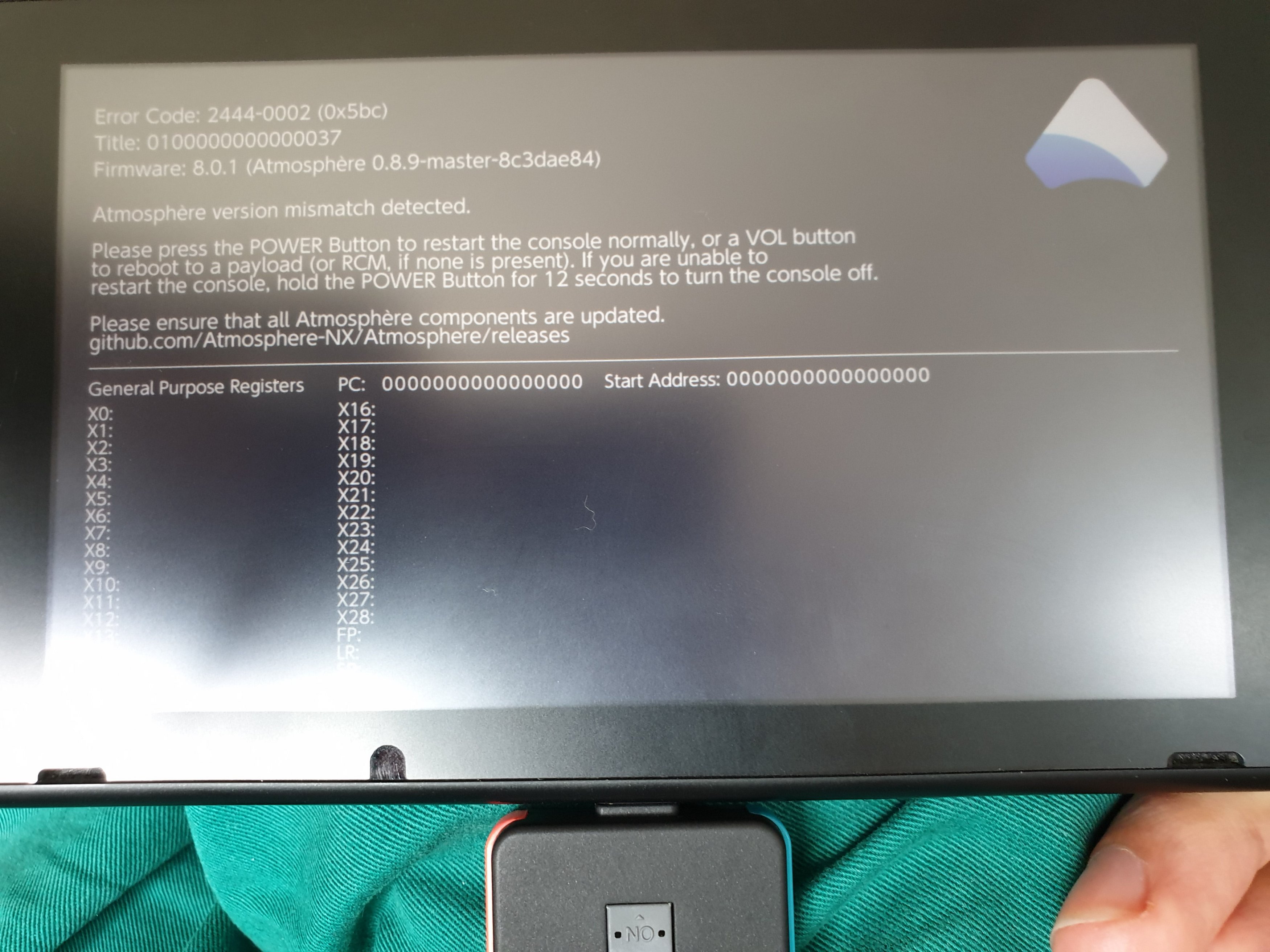

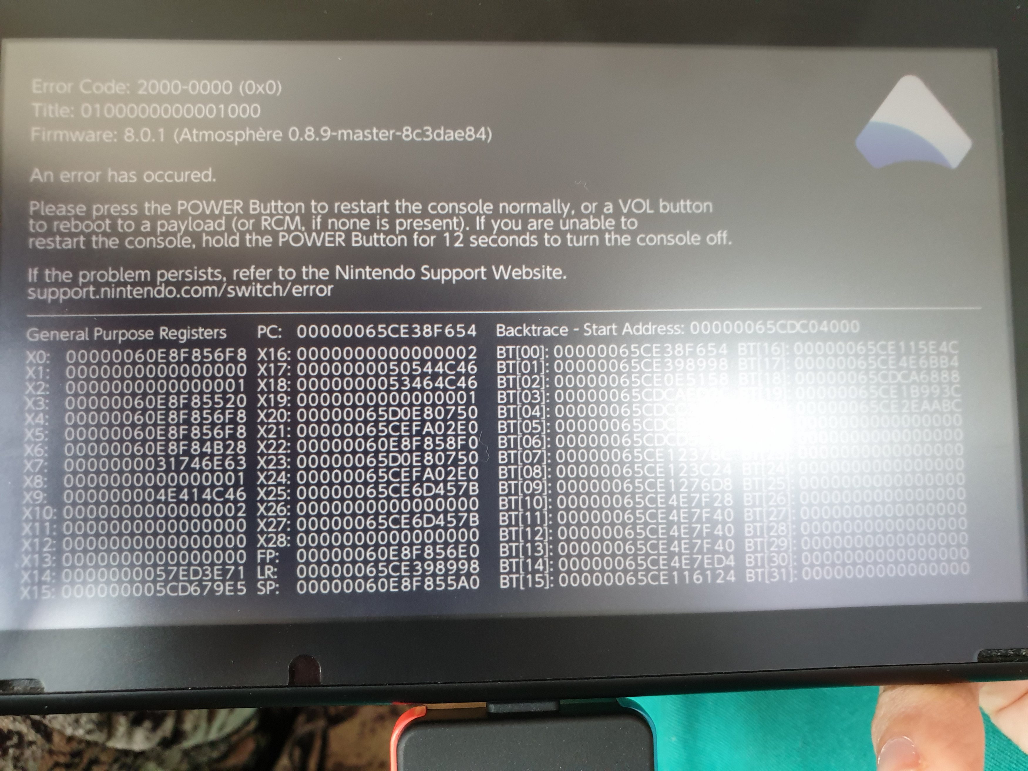

I was on 7.0.1 and updated to 8.0.1 with ChoiDujourNX (newest version).
Although I have Atmo 0.8.9 through Kosmos I can't boot into either Atmo with Hekate, Atmo with Fusee Primary or SX OS.
Everything leads to the error stress screen.
However booting Stock through hekate works.
What am I doing wrong?
Error hekate -> atmo:
Error Fusee Primary -> atmo:
Happens in various situations, not necessarily an error, but still prevents booting. If you got this because you downgraded, it's because you downgraded between major/key versions (7.0.x -> 6.2.0, 6.2.0 -> 6.1.0 etc) without console initialization (deleting system save files). To recover from that: Delete system all save files except 80...120. Keep in mind that this will effectively be a factory reset.
Thx but as someone else already stated it seem to be the themes (for whatever reason).
After renaming/removing the themes folders from sd:\[cfw]\titles\ all CFWs were working again. :)
