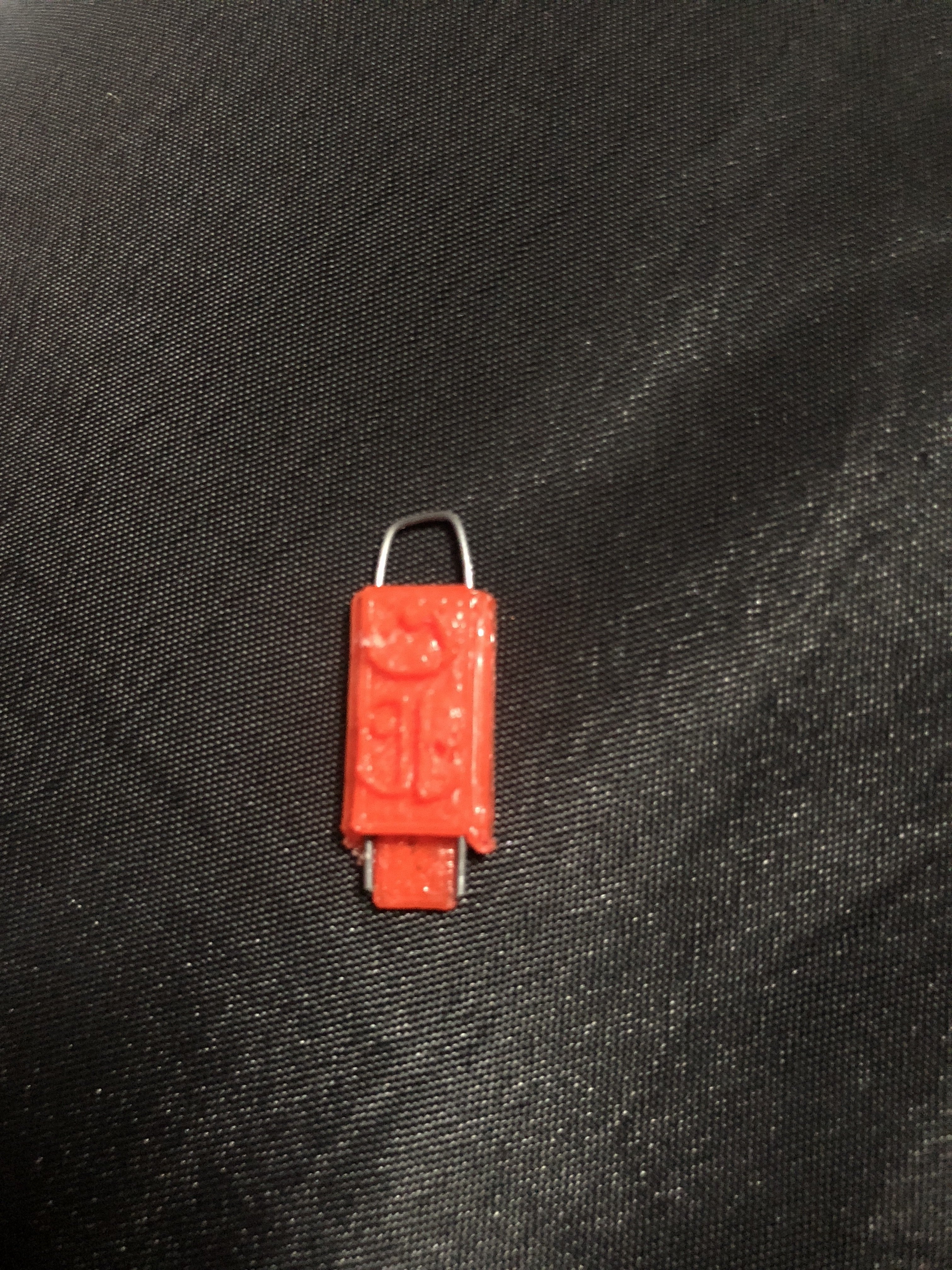

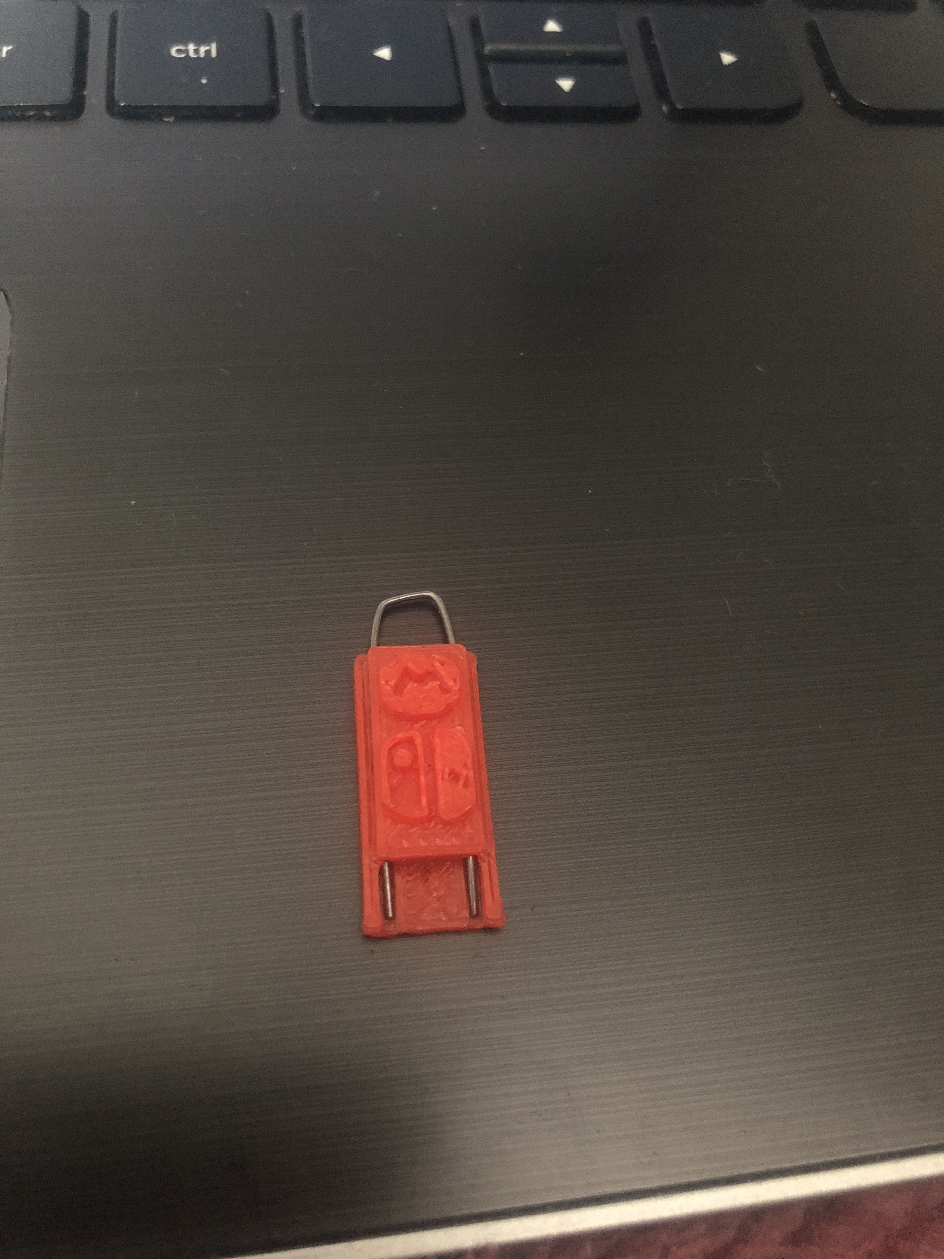

i ordered a jig on ebay and was advised by the seller not to use it as it could damage my switch so i waited for a replacement and i cant get in RCM mode now...anything i can do to adjust it and make it work?

You sure it hasn't damaged the pins on the rail?
Maybe try pushing the metal down a little more, there does look like a slight gap at the end, may just not be reaching it.

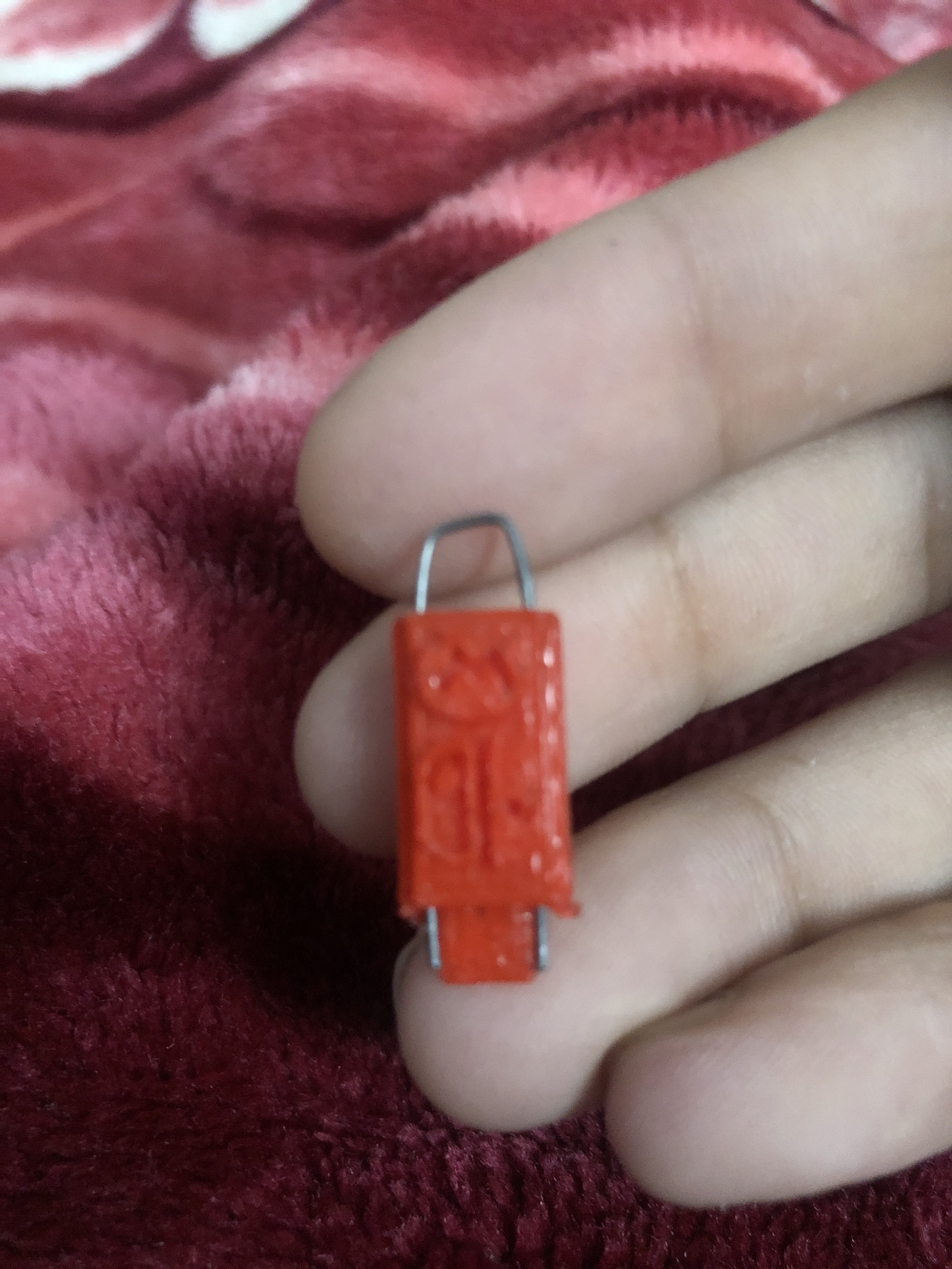

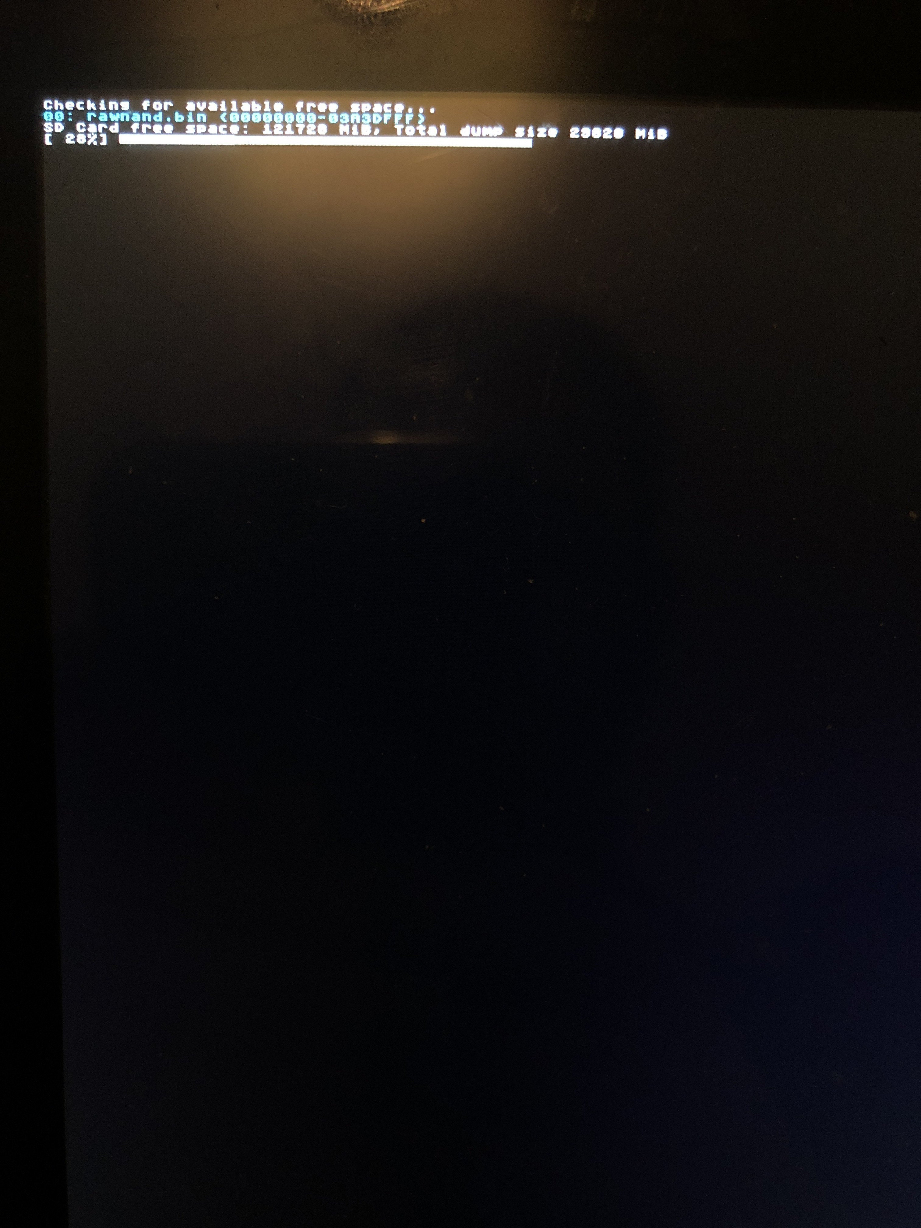

So i plied off some of the plastic and bent the pins a little and managed to get it to work! Thanks to you guys :D:grog: time to dump my nand
