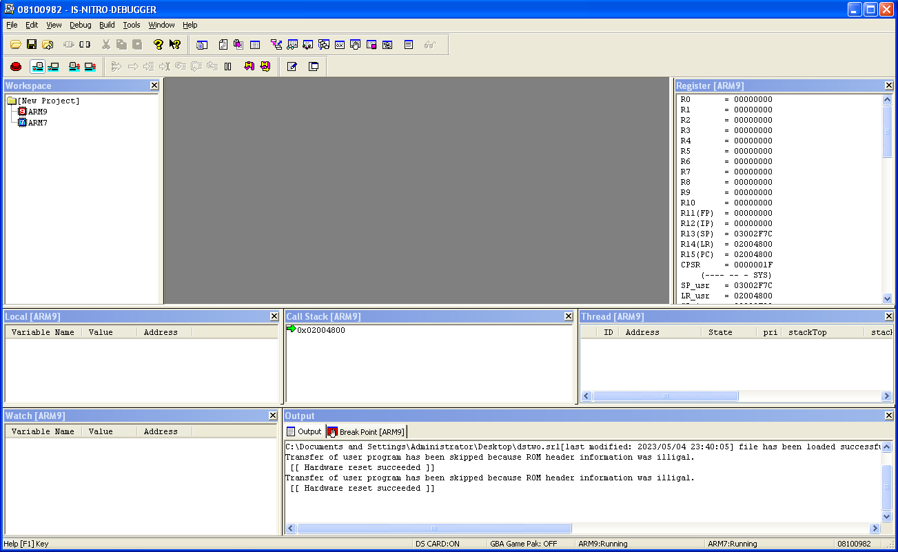

Is it possible to use a flash cart with the IS-NITRO-EMULATOR? It would be great to be able to use one for save files and slightly easier switching of games, instead of having to process them all in an XP box after dumping, I could just run the dumped images directly. I have a Supercard DSTWO and I attempted to just run the `dstwo.nds` file renamed to `dstwo.srl` but it didn't work.

But this is done in hardware, the flash cartridge is physically inserted into the device. I suppose I'm not sure how the flash carts get the data across, thinking about it a bit it's definitely not the SPI stuff for saves because that would be too slow, so maybe it's just not possible with the virtual cartridge that's built into the IS-NITRO-EMULATOR.
