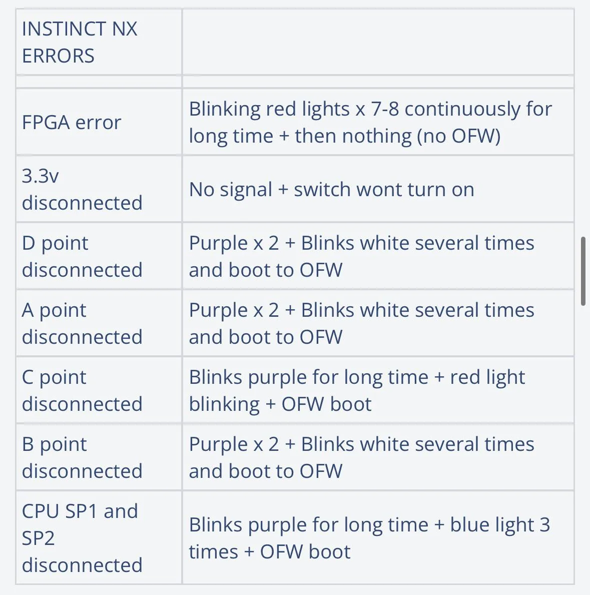

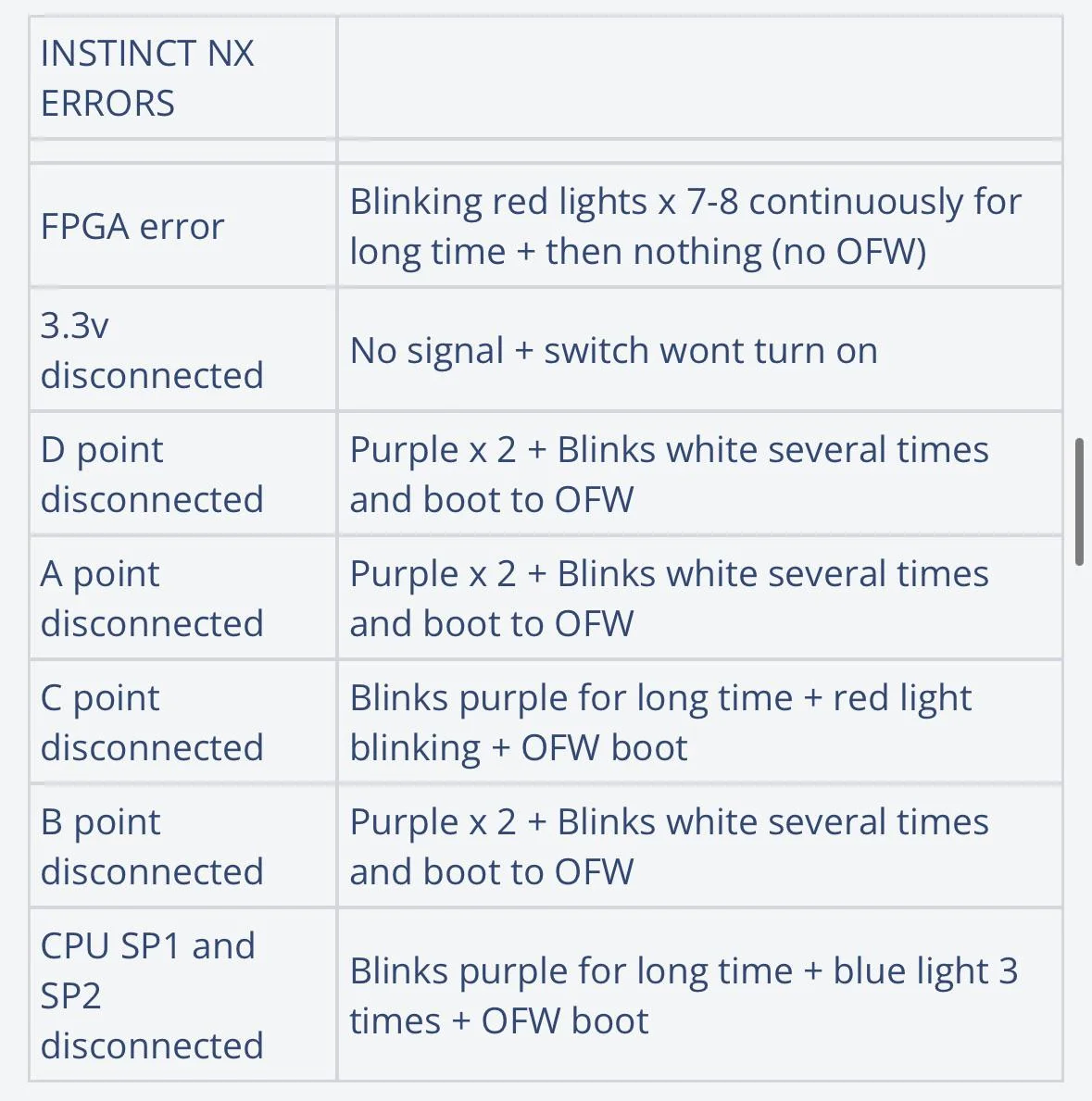

What else should I have to check? I am stuck now...
Any suggestions are welcome
