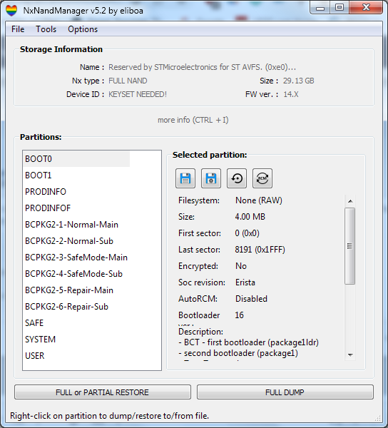

I think you need NxNandManager.
Open your DMG file by NxNandManager, and in configure the keset menu, import your switch's prod.keys.
Then you can see your save files in USER Partitions, just extract them or mount the partition, then you can do what you want.

But that's the thing, NxNandManager can only open what it sees as actual connected disks, and I can't seem to find anything that'll let me mount the DMG or at least convert it to an ISO... but I guess using "open file" in NNM is worth a shot.
In fact the DMG created by disk drill is also a format of bit to bit stream, which is similar to nand backup binary file in hekate. So it can be read by NNM. But you still need the corresponding prod.keys, due to the nand partitions are encrypted.

I see. I ripped a fresh (sysnand) prod.keys via lockpick, (since i somehow lost the prev ripped keyset. dunno how!) and just made a "FULL NAND" backup from the DMG, then restored that full backup to the "fresh" emunand (idgac if its called emummc theyre the same thing tbh) via USB.
I know I could've just ripped and restored just the USER partition, but not doing a full restore felt... wrong.
Additionally is just kinda had a file copy error at the very end (while restoring the USER partition) but the emunand works perfectly so eh, crisis solved I guess.
