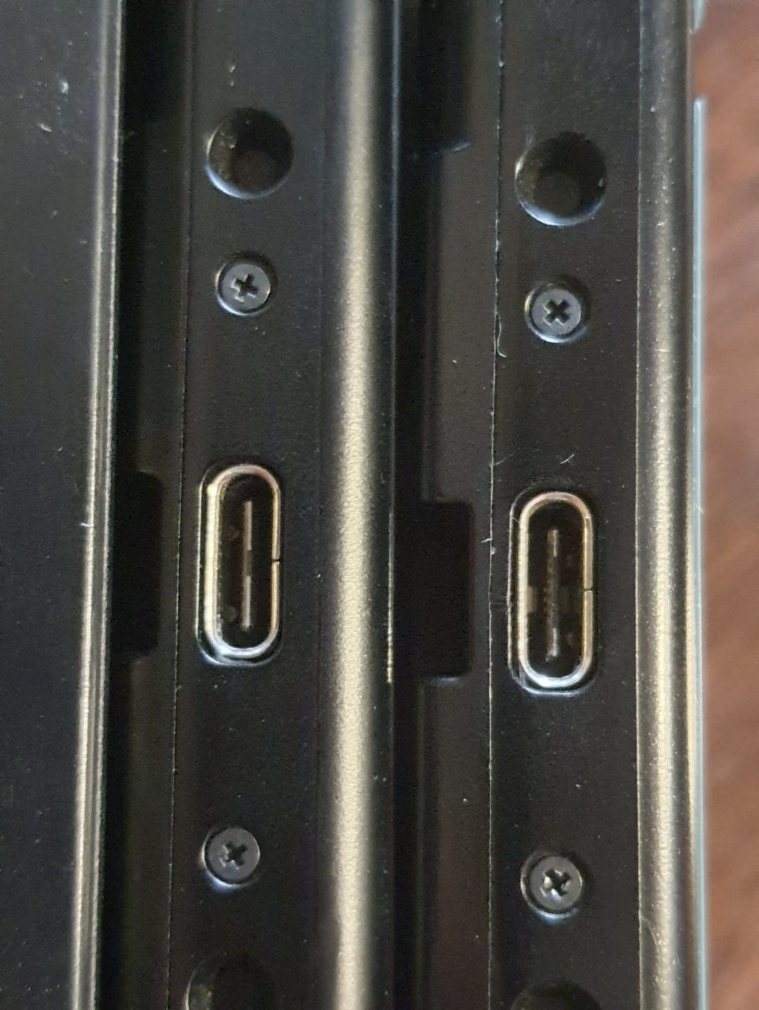

This is the best i could do
EDIT: the right one is the modded switch

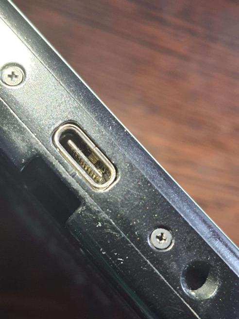

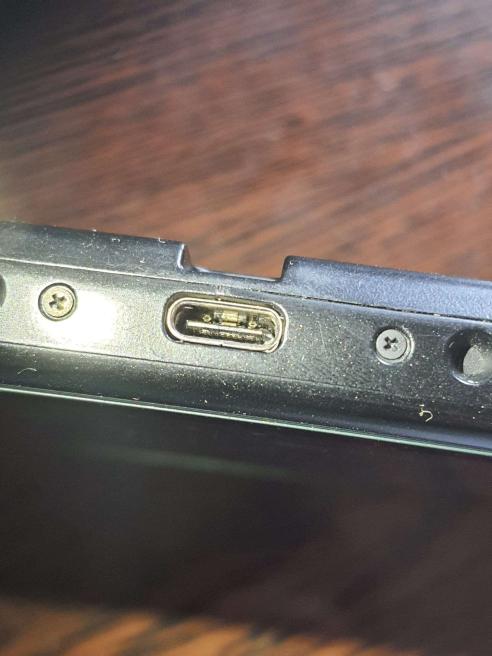

Well, you should angle the camera when you take the pic, and try to get both sides of the middle piece (take 2 pics), but already it seems that one of those pics is not like the other…
Like I said, it’s hard to get a good pic. Not only does it need to be at an angle, but you need to get some light in there, so we can see better. Still a good chance the socket is damaged, but I couldn’t say for sure with that pic. TBH, you need a digital microscope to get a good pic.

first is the back second is the front.
