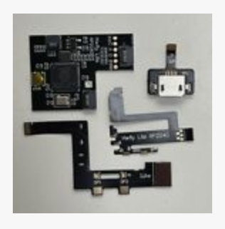

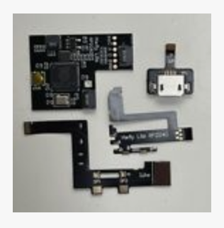

I purchased a HWfly v6 chip / ribbons from ebay a few weeks back. I was a little wary b/c i hadn't seen a version of HWfly that looked like this (different 3.3v location), however since then i've seen them pop up in different places.

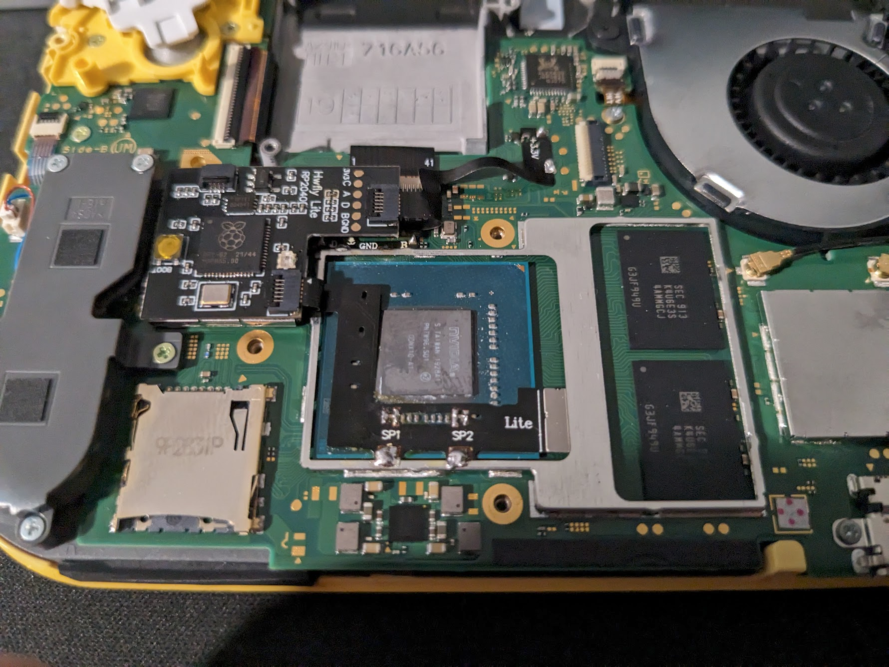

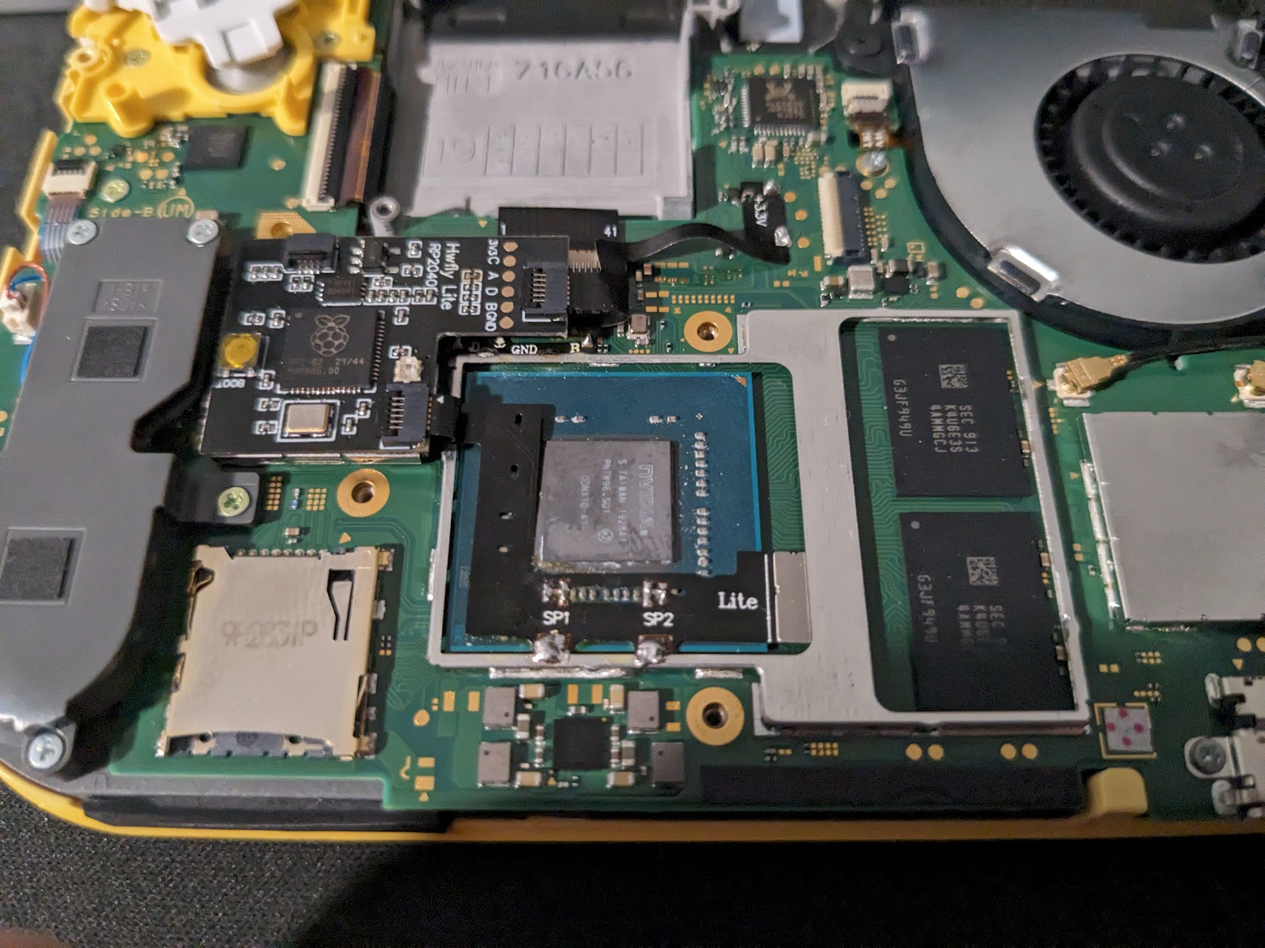

I installed the chip this week with the included ribbons and used the usb attachment to update the FW to 2.73 from the picofly thread.
Not a super pretty install, but it works. I've never soldered this small before.... and it is SMALL. I used a sub-$20 usb microscope and a Hakko 888 and paste flux, it was ok... I solder bridged SP1 at one point and was able to solder wick it without killing/displacing the cap.... Yikes...
Anyways, its workingl! Just wanted to share that these work well w/ the 'known' picofly FW.
