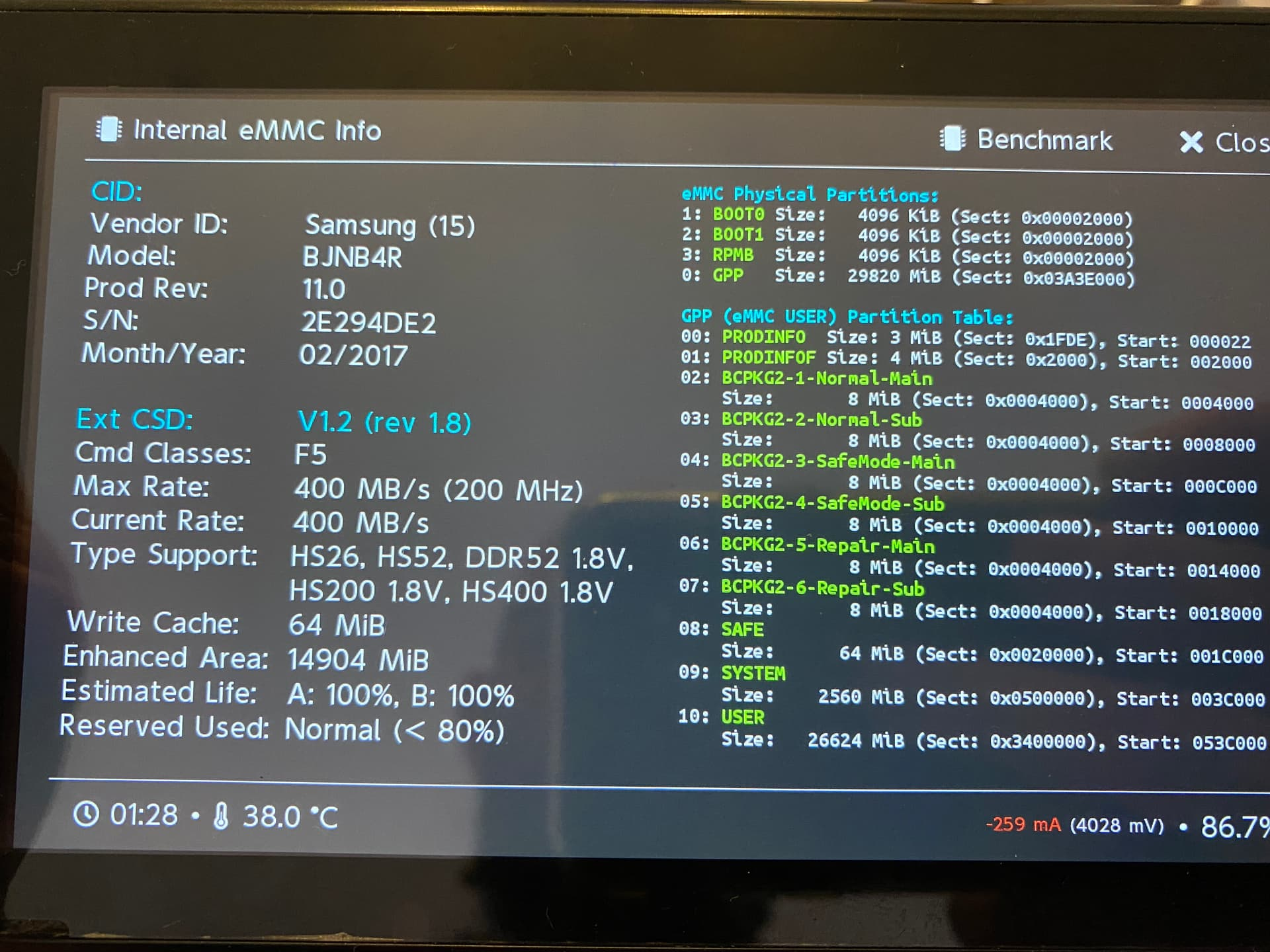

Update: when restoring boot0 and 1 from Hekate I get a warning that the emmc is initialized in slower mode, "might mean hardware issues".
When entering emmc info it mentions:
Bus speed 200 MB/s
Init fails: 0
Read/write fails: 2
Read/write errors: 0
First of all, what is your emmc manufacturer? Those V5 chips with BGA FPGA is always finicky about emmc, would work on samsung, but sk hynix is a hit or miss and toshiba is nightmare. According to my supplier, V5 is manufactured by a different group trying to clone V4. V4 is rock solid and works great with stock or hwfly-nx firmware, while V5 isn't. To make things worse, many V5 chips on aliexpress are fake, so I'd never recommend people using them.. Go with instinct nx or rp2040.
Anyway, since you already bought and installed it, I'd say stay on stock firmware. Some clones are known to corrupt your emmc. Is your partition info still intact on emmc info page? As for bus speed, it should be 400MB/s, so something's not right. Try to reset your dat0 adapter, if that didn't help you might need to reball the emmc and solder directly to dat0 pad. Also send some pictures of your installation if you can.

Hi Randy, thanks for your reply.
It's an SK Hynix, here's the information, the partition information looks intact I think
I did try different DAT0 adapters without result. The diodereading is fine. I encountered another topic https://gbatemp.net/threads/emmc-slower-mode-200-mb-s-hwfly-v5.628352/
in which the cmd capacitor was bridged to the component next to it, see below. This might be the case with my Switch also; since all the diode values were fine and the glitching fast and consistent UI assumed my install was fine.
I'll open up my Switch and check this later today and report back on this.
Your partition table is empty! There should be partitions like this:
Thant's really bad, try to check your connections first, if nothig wrong then seems like the mod chip corrupted your emmc.
Reactions: Danster75

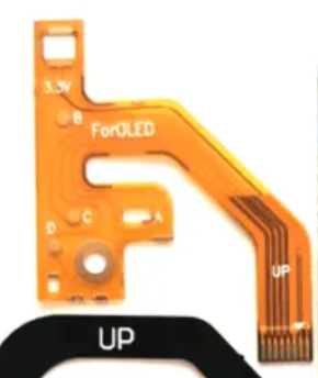

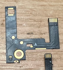

I removed the flexcable and went for a cabled install instead
You mean the flex cable for point A, D and 3.3V?
Man this flex cable is pure garbage. It's known to cause interference at rare occasions and prevent console from booting, also it's not very precise, doesn't align properly. Most importantly, when you screw in the heatsink through the hole on flex cable, it puts stress on A and D points, and it could rip them off from motherboard. Anyway, just throw them away and go with direct connection instead..
I got this one. Alignment was ok but indeed not very smart for the screwhole to be integrated.
