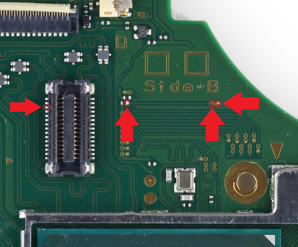

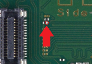

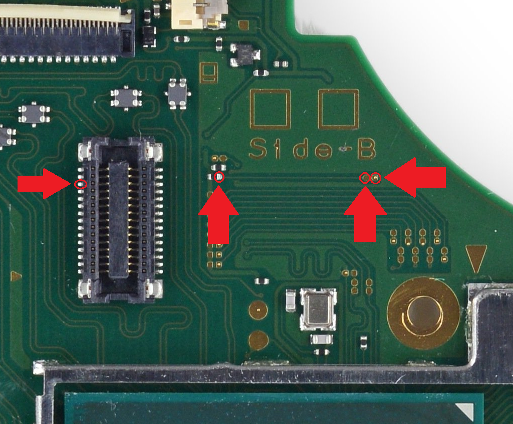

hey where can i find the cmd point in the older switch motherboard.
I don't know which one it is I'm trying to use this board as a donor for my OLED
I'm 99.9% sure, that these 4 points are alternative CMD points:

@JaRocker
I don’t have a Mariko PCB to help you, but I would advise you to use a multimeter to find the resistor yourself.
It will be faster than waiting for someone do it for you. And doing it by yourself, you’ll have confidence that you got the right resistor.
my multimeter isn't working idk what's up with it
