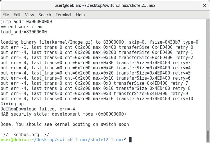

To check if it's working fine execute ./boot_linux.sh script as shown below:
Then you have to find your own way to enter RCM mode (using, JoyCon mod, 3D printed JIG, paperclip, whatever.)
It should automatically power up your Switch and you should see NVidia APX device detected (which means you are in RCM mode). If you see Nintendo logo booting it means that you did something wrong and you have to start process again.
If everything went fine you should see logs as below on your host computer Linux terminal:
Then you should see penguins and kernel bootlog on the Switch.
If nothing happened try again. Actually this method is very accurate for me and other people around. If you have no luck here it might be problem with your USB connection either USB controller or USB cable. It has been proven that USB3.0 on host PC natively running linux work best.

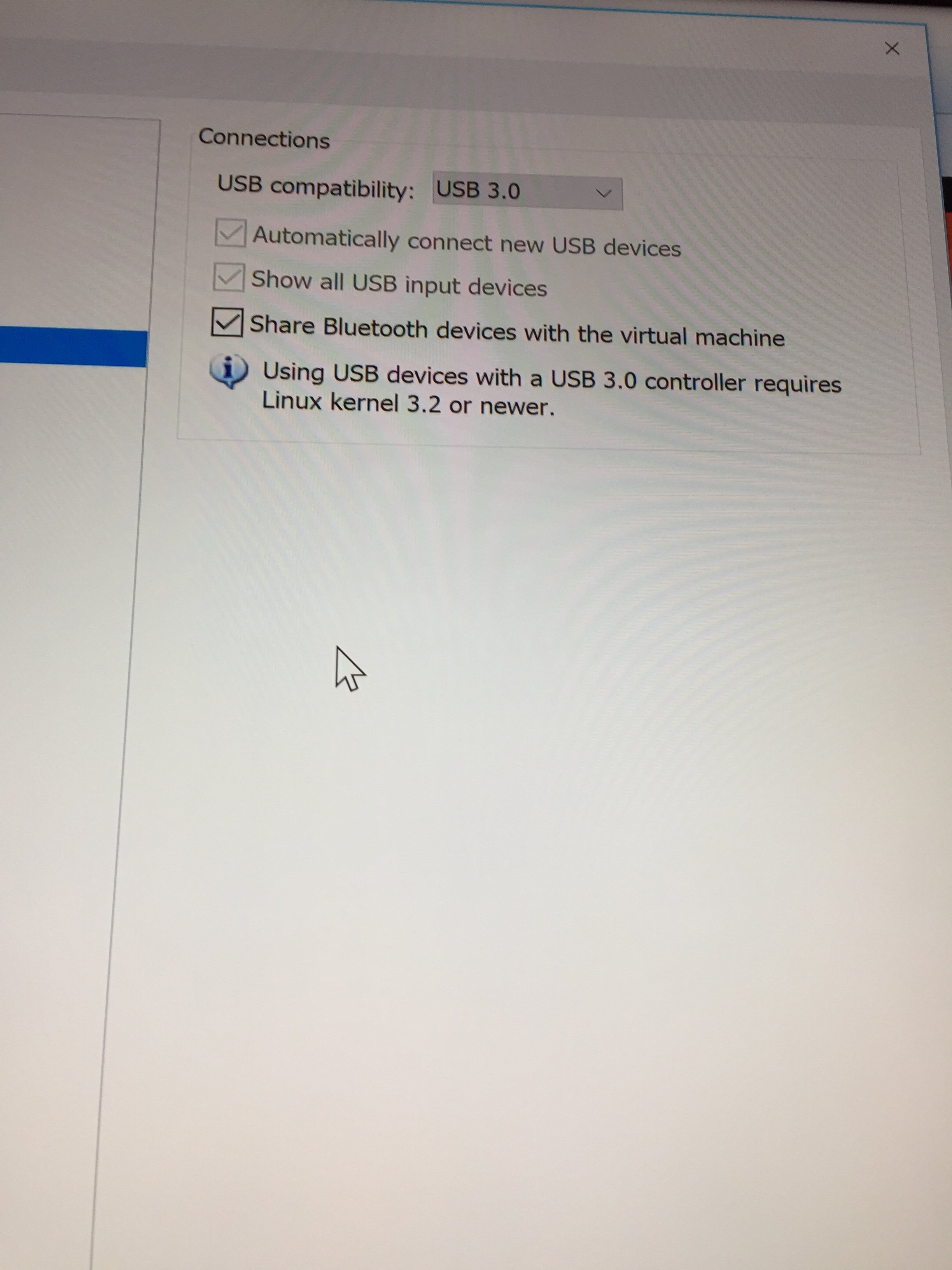

First thing you have to do is getting exploit environment ready. Currently available tools works only under Linux and OSX. As I have nothing to do with OSX you have to compile and prepare everything by yourself. This guide is strictly for using it with so called PC instead of Mac.
Considering you are using native linux runing on your host computer or virtualised linux running under VMware (VirtualBox was reported as not working) the easiest method to get f0f exploit with kernel without need to compile anything is to get precompiled binaries from git repo:
root@vmk:~# git clone https://github.com/SoulCipher/shofel2_linux.git

File descriptor: 9
b'400205050000000841763c6401101062'
entry 400168ed
throwing more
Performing hax...
b'820000000000686c'
b'0200000000000000000000000000000080d3160100000000716c000000000000000000000000000000000000000000000f0f00000000000000'
URB address: 0x1137220
URB status: -2
b'CBFS\n'
>>> Switching to cbfs mode...
sending 0x7000 bytes @0x0
sending 0x4 bytes @0xffffc
sending 0x20 bytes @0x20138
sending 0x18 bytes @0x20100
sending 0x20 bytes @0x20118
sending 0x18 bytes @0x20180
sending 0x20 bytes @0x20198
sending 0x1c bytes @0x201b8
sending 0x533e bytes @0x201d4
sending 0x100000 bytes @0x0
you have been served
Detected. Waiting 5 seconds
config file <conf//imx_usb.conf>
vid=0x0955 pid=0x701a file_name=switch.conf
config file <conf//switch.conf>
parse conf//switch.conf
conf//switch.conf: syntax error: _direct 0x8e000000
{image/switch.scr.img:load 0x8e000000,jump_direct 0x8e000000
Trying to open device vid=0x0955 pid=0x701a
Interface 0 claimed
HAB security state: development mode (0x56787856)
== work item
filename kernel/Image.gz
load_size 0 bytes
load_addr 0x83000000
dcd 0
clear_dcd 0
plug 0
jump_mode 0
jump_addr 0x00000000
== end work item
load_addr=83000000
loading binary file(kernel/Image.gz) to 83000000, skip=0, fsize=8433b7 type=0
<<<8663991, 8664064 bytes>>>
succeeded (status 0x88888888)
== work item
filename dtb/tegra210-nintendo-switch.dtb
load_size 0 bytes
load_addr 0x8d000000
dcd 0
clear_dcd 0
plug 0
jump_mode 0
== end work item
load_addr=8d000000
loading binary file(dtb/tegra210-nintendo-switch.dtb) to 8d000000, skip=0, fsize=a040 type=0
<<<41024, 41984 bytes>>>
== work item
filename image/switch.scr.img
load_size 0 bytes
load_addr 0x8e000000
dcd 0
clear_dcd 0
plug 0
jump_mode 1
== end work item
load_addr=8e000000
loading binary file(image/switch.scr.img) to 8e000000, skip=0, fsize=162 type=aa
<<<354, 1024 bytes>>>
jumping to 0x8e000000
Done. You should see kernel booting on switch soon
