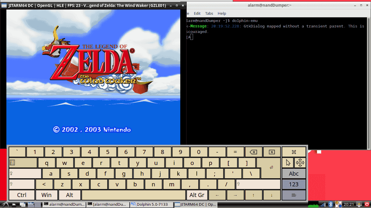

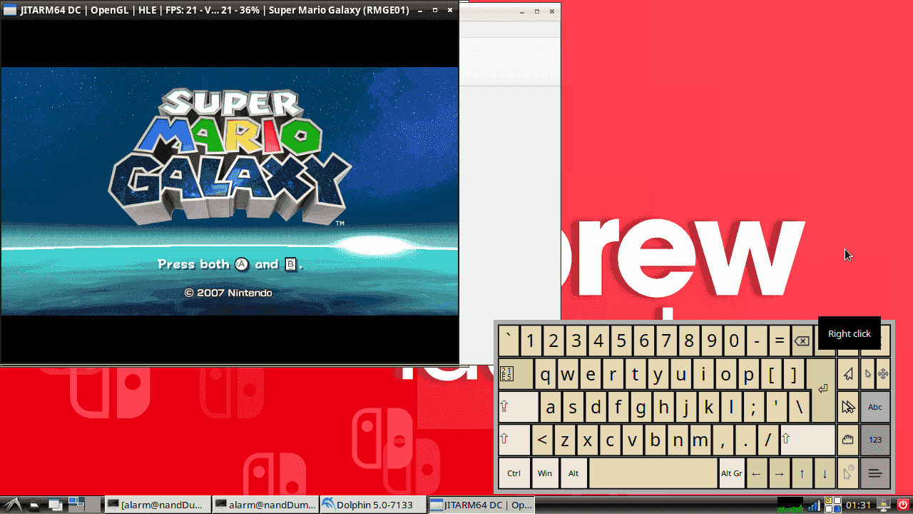

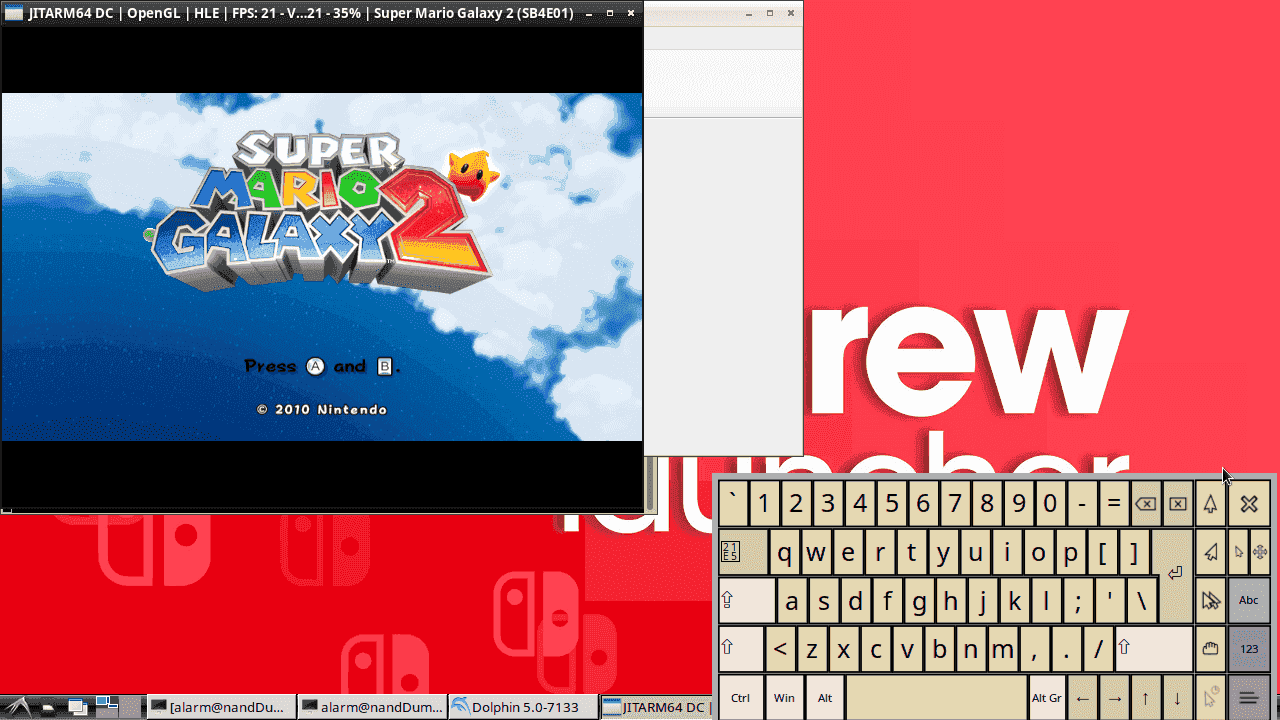

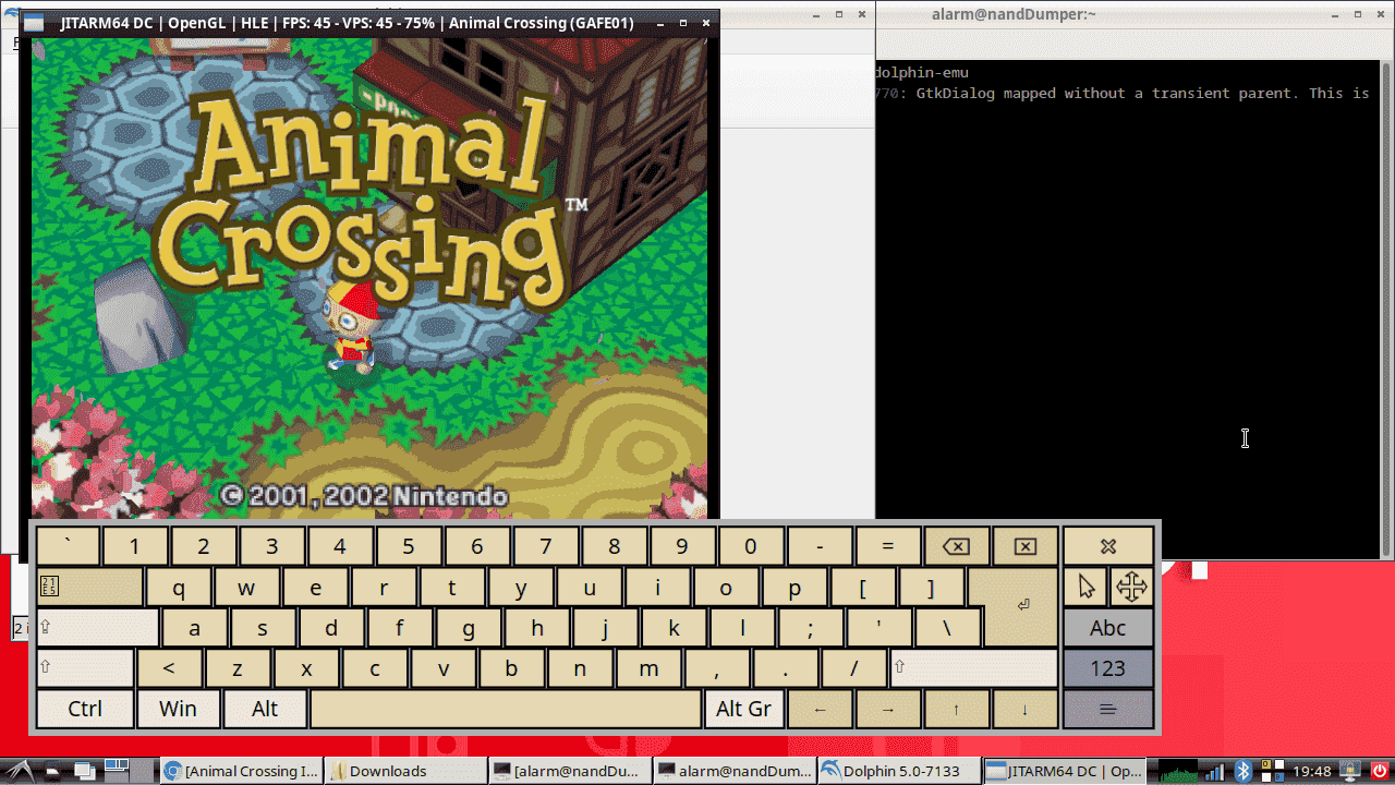

@Gigaa it looks like the "normal" power mode makes the system very unstable, each time I enable it the console crashes after 5min (not back to RCM), whether I'm doing CPU or GPU intensive tasks. The console also heats up a lot.
@natinusala Instead of running the following:
echo 0a > /sys/kernel/debug/dri/0/pstate
Try running the following:
echo 0a > /sys/kernel/debug/dri/128/pstate
if that doesn't work, try the same command with 129, as they may switch, depending what is loaded first. See if that is more stable. I'm running the following using 0d (998 mhz) with no stability issues so far.
