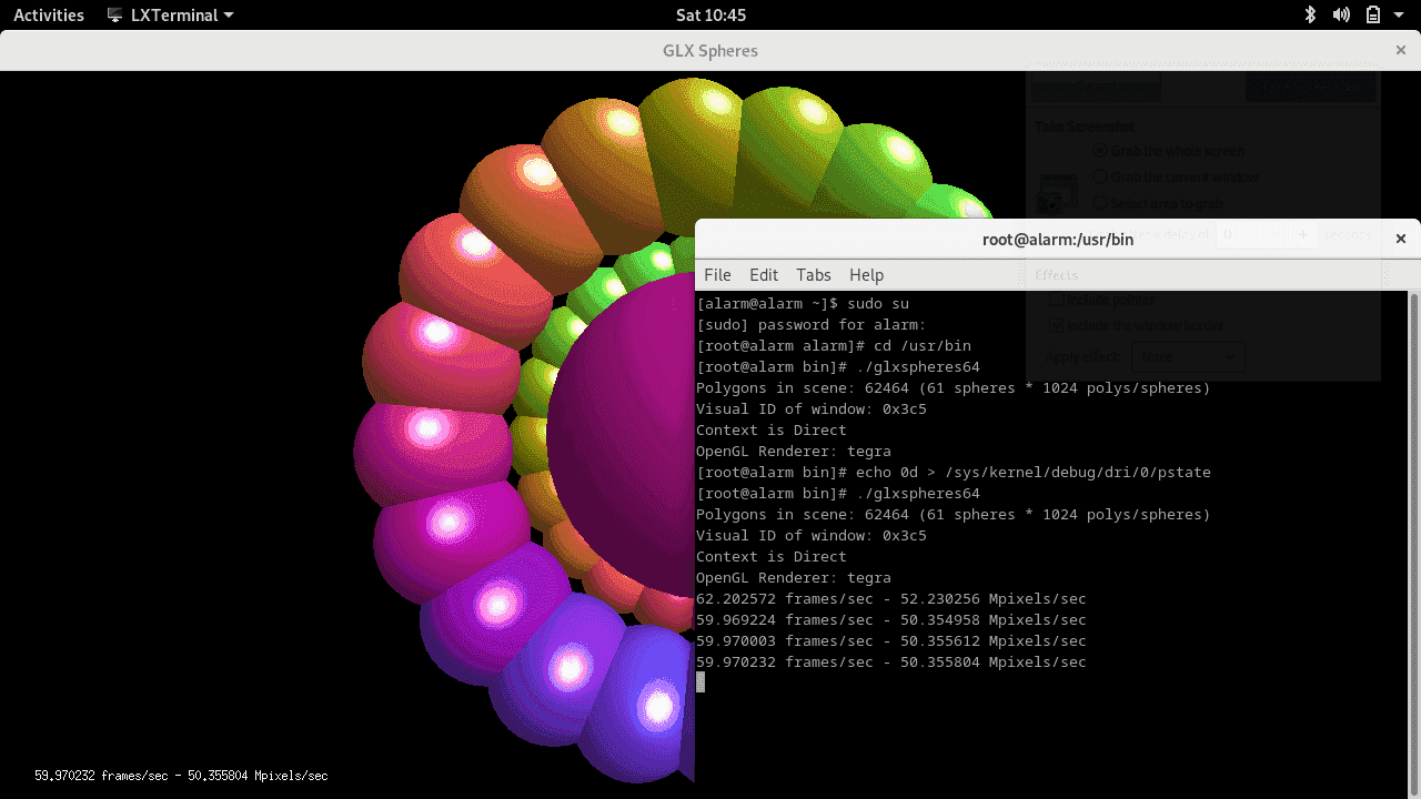

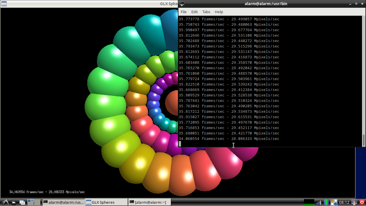

The result
Without a SD card ("waiting for root device mmcblk0p2") : https://photos.app.goo.gl/7y6ut5ObuHMUIMZg2
Stock Arch Linux : https://photos.app.goo.gl/yALqe3zMZRe2dSQf1
Arch Linux with LXDE : https://photos.app.goo.gl/xaEgRqeSi8jvAwpz5
RetroArch running : https://photos.app.goo.gl/vBLPo5wiBto1qiUH3
Arch Linux with GNOME : https://gbatemp.net/attachments/img_0005-jpg.121608/

  • GPU acceleration : works (via mesa), with OpenGL (and maybe Vulkan too ?)

I've figured out how to get the gpu running at fullspeed as F0F did! Turns out it's a power management issue with the nouveau drivers, and all you have to do is run this command as root:
echo 0d > /sys/kernel/debug/dri/0/pstate
This will force the GPU clock to run at 998mhz.
Attached are the old and new results of glxspheres.
@natinusala I can confirm that the gnome image does have working Wi-Fi
