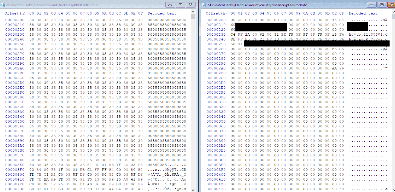

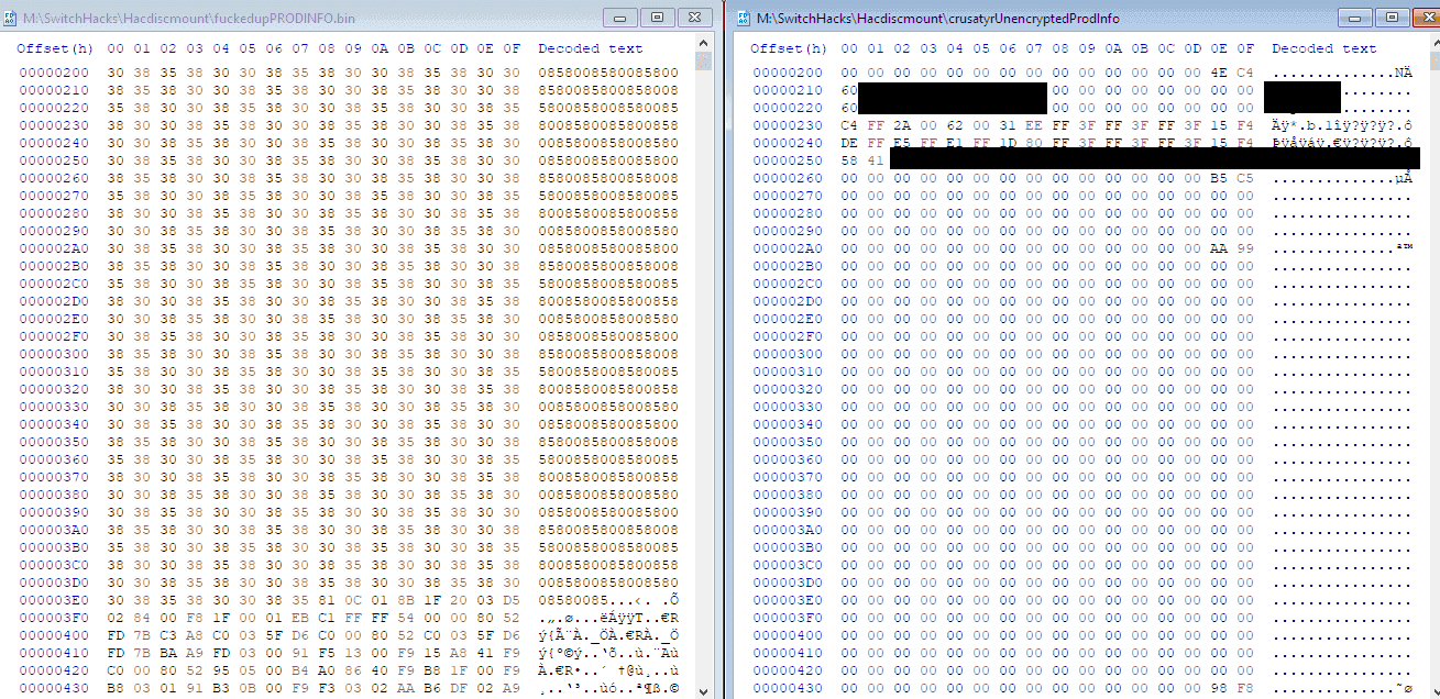

so only the first 5000 bytes get overwritten with '80085' but the next 0x5000 minus 5000 bytes still get overwritten by whatever else was in that buffer at the time of the malloc
so only the first 5000 bytes get overwritten with 0x0800000805 but the next 0x5000 minus 5000 bytes still get overwritten by whatever else was in that buffer at the time of the malloc
Yep. Zeros.
Yep. Zeros.
Not zeros, literal garbage data. Here's an unencrypted ProdInfo that got fucked up. You can see in the following picture that "80085" stops at offset 0x3E7, and the rest of the data is nonsense compared to the legit prodinfo on the right.
Edit: You might be thinking of calloc which fills the buffer with zeros.
whoops yeah, only the first 1000 bytes which is why it stops at 0x3E7. if it was calloc instead of malloc, the rest would be zeroes. and i'm sure they meant to do either
for ( int i = 0; i< 0x5000; i+=5 )
    sprintf(&buf[i], "80085");
or
for ( int i = 0; i< 0x1000; i++ )
    sprintf(&buf[i*5], "80085");
Yes. After the garbage data. Mostly zero'd where the certs should be.
I think that the first thing checked in the prodinfo is the sha256.
This will probably won't work, but what would happen if we put serials back (start from a legit prodinfo, copy/paste over the serials our "target" serials), forget the certs, recalculated the sha256, implanted it all into a pikabricked prodinfo.
Which is uncorrupted after offset 8000.
