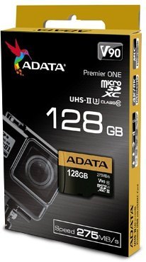

Does anyone own a fast card like Adata Premier ONE V90 128GB (275MB/s) to test speeds on?
If its double the speed it may be worth the purchase.

How come? Is their obfuscation the reason or is the SD card slot too slow?
Nope, the SD card reader is not that slow, all original like tested for months already shows that every eshop game loads faster from the M-SD than game carts.
However yes, the SD port is also not that special as all Sandisk ultra vs Extreme shows Extreme faster card to be actually slower by a very small margin (though they were all non A1 tests that I have seen).
Switch Can't sadly support those faster M-SD cards, it doesnt have the other pins and actually almost no device in the world take advantage of them...
ea33d81791ff4906a417c0feee549b34-jpeg.74865
UHS2 is also same as UHS3 pins...
ps: At least everyone out there reports that the Switch doesn't support those speeds, its just compatible, but will run at a normal M-SD card on the Switch.
