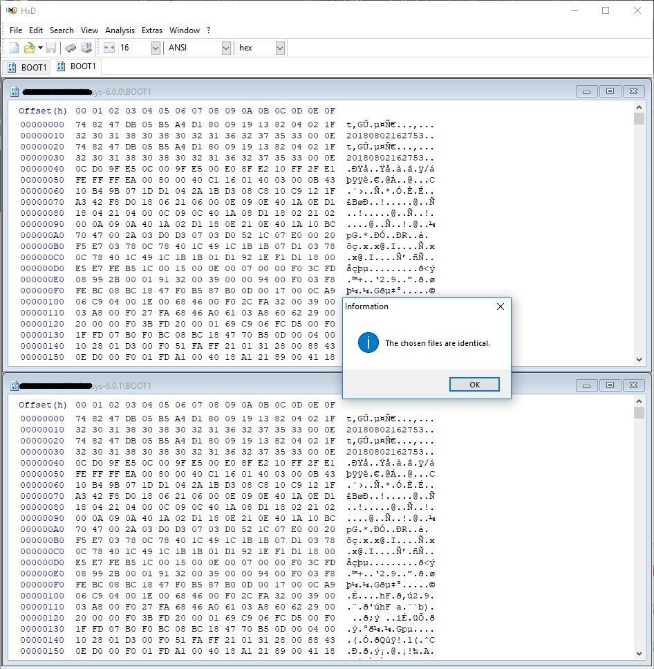

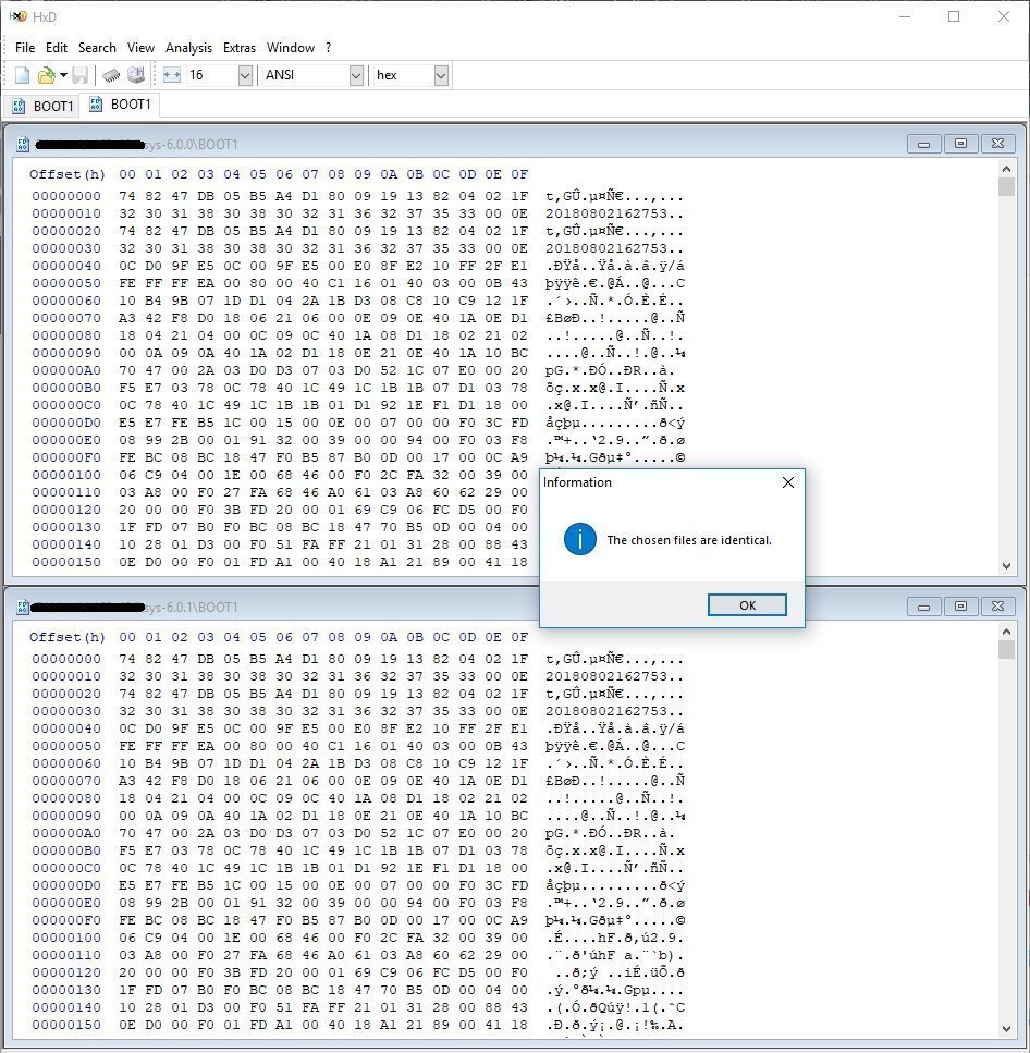

The problem is when updating Sysnand, the firmware will patch BOOT0/1. Emunand signature is on BOOT1, after updating, SX OS won't recognize Emunand anymore.
Solution: Backup BOOT1 (unchanged after updating) when having Emunand setup.
Use Hekate to restore BOOT1 back after updating System to 6.0.1

Are we sure that BOOT1 is identical on 6.0.0 and 6.0.1? Otherwise restoring the BOOT1 from 6.0.0 on 6.0.1 might cause problems down the road.

YES 101%.
