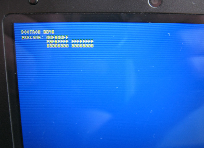

I will try to explain my current Situation. You See im a very impation Person so instead i used a discord that i forgot i joined a few months ago and this Here is how far i got so far
this is godmode9 and i can only start gm9 with fastboot 3ds when i remove my SD Card and start the console it shuts down a few Seconds after that
Cross posting in various locations is confusing.
Discord is not a nice thing by the way. Results of discussions aren't publicly available and don't get indexed by search engines → Potential solutions not easily accessible for somebody else searching for similar topics.
But that is admittedly off-topic. So back to the problem.
No matter from where you got to read "Fastboot", it won't help you now (unless already installed). Fastboot is an alternative bootloader; a bit more versatile than B9S, but ultimately both achieve the same. Highly likely your console has B9S right now. All you need – given the SD reader is working – is a FAT32 formatted SD containing boot.firm (Luma3DS). This should be enough to power on the console.
If you provide GodMode9 from the finalizing archive on 3ds.hacks.guide you should be able to start it by holding (Start) button on power on.
ntrboot is only helpful if the bootloader is destroyed as well. Not very likely as trashed FIRM partitions should result in 8046 BOOTROM ERROR blue screens of death.
3ds_blue_screen-jpg.220805
So if i so this Here my 2ds should Work normaly again? I Hope so because i was ready to throw it into a Trash can and buy me a Other used one.

From what i could gather from the Discord conversation op has a corrupted CTRNAND partition and no backup hence why the mount error in Luma3DS. The only thing that can save this console now is data forensics. Someone has to extract important files from the corrupted partition and then we can build a new partition.
And strangely it won't boot GodMode9 directly as boot.firm either. That's why fastboot3DS was mentioned.
Somehow the picture above didn't show up for me when I opened this thread the last times. So I didn't even notice OP is already able to start up GodMode9 now. My last messages look foolish because of this. Well. Shit happens.
Missing partition should not have any impact on ability to start FIRMs.
Too tired right now to do tests.
I've thought of this (trashed partition) right away but needed confirmation.
This is the last time I even participate further in a discussion where Discord is mentioned. Not being able to see important information (other than being stupid and missing a picture for whatever reason) is really a bad position.
Console unique data could still be accessible within the embedded backup
[S:] SYSNAND VIRTUAL/essential.exefs
We have had "no backup, missing partitions" before. It should be fixable by CTRTransfer Type D9 script.
Really important at this point is backing up the current status before anything else. Radical repair attempts can fail and make things worse.
That is indeed strange. I've not the faintest idea why this should happen. To me it sounds like hardware damage.
Either usual abrupt shutdown because of missing peripherals (worn cables, drop damage, water damage…) which shows by immediate blue LED off instead of fading (controlled shutdown)… or something more subtle. Bad NAND chip. Bad RAM or the like.
But I'm fishing in the dark here.
