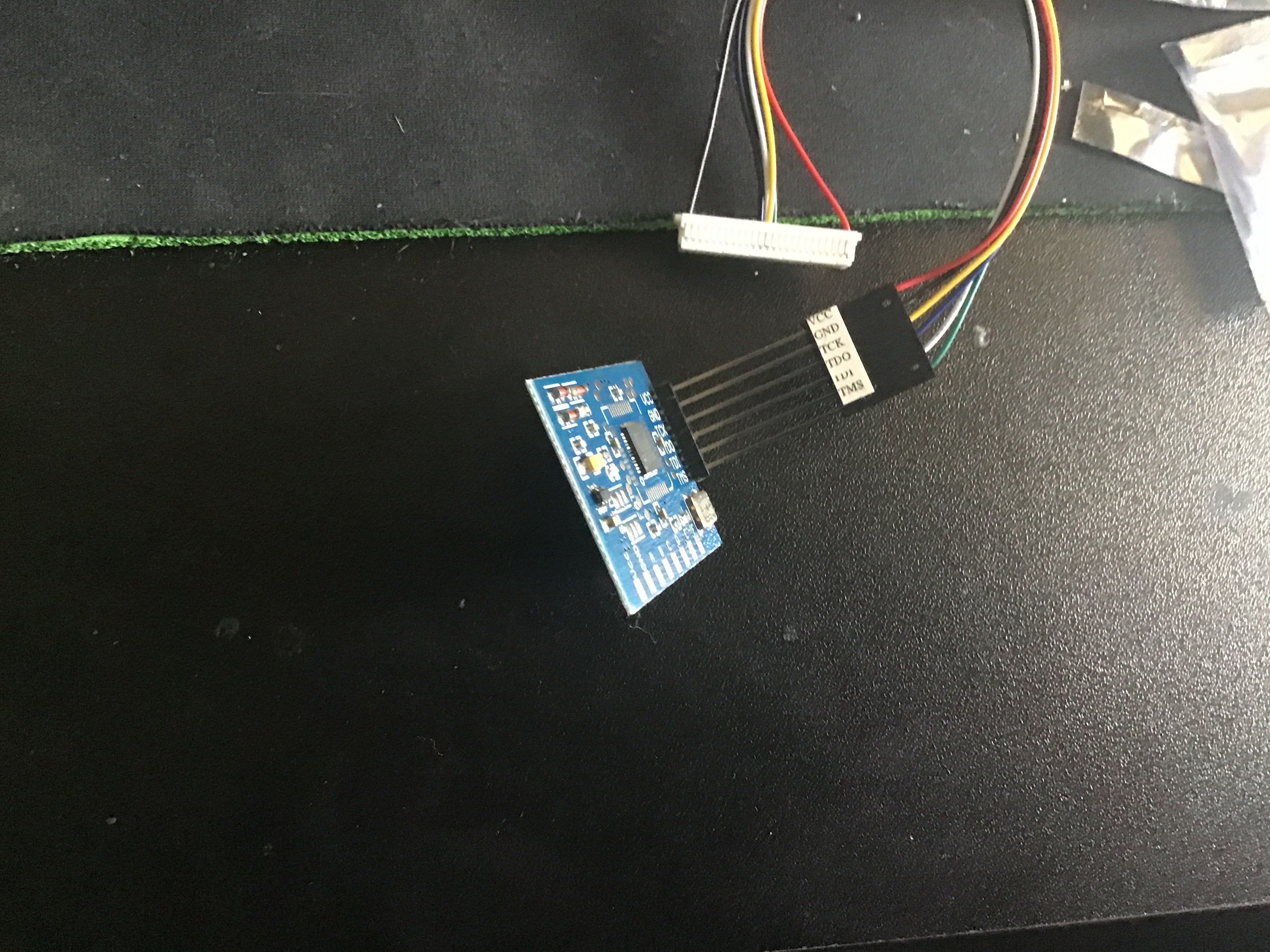

Ok so i recently received my NAND-X and Matrix V3, but then i noticed that the Matrix has no pins for the NAND-X to slot in to. So now im wondering, how am i going to put a timing file on this thing...

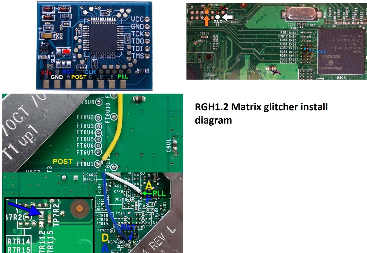

You wire these points to your Nand X, then use Jungle Flasher on PC.
Either direct wire, or add pinheaders to the Matrix board, like this:
Get a 6 pin header you'll be able to connect the NAND-X wires to and you'll have to hold the header at an angle while you r/w to your chip... if you don't wanna modify/ solder NAND-X wires.

So it turns out i had a few of these lying around, and i have this now, i plan to trim it and solder it thoughView attachment 553282
You don't have to solder the header in place to save on real estate inside, l you could just hold the header at an angle to make contact during the 3.5min read.
