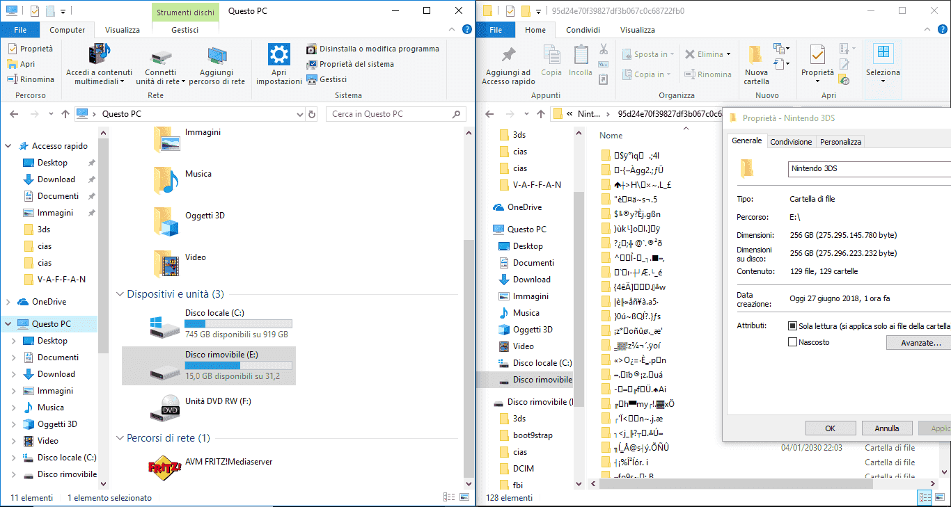

wait... WHAT (that's my 32gb sdcard)
seems legit
