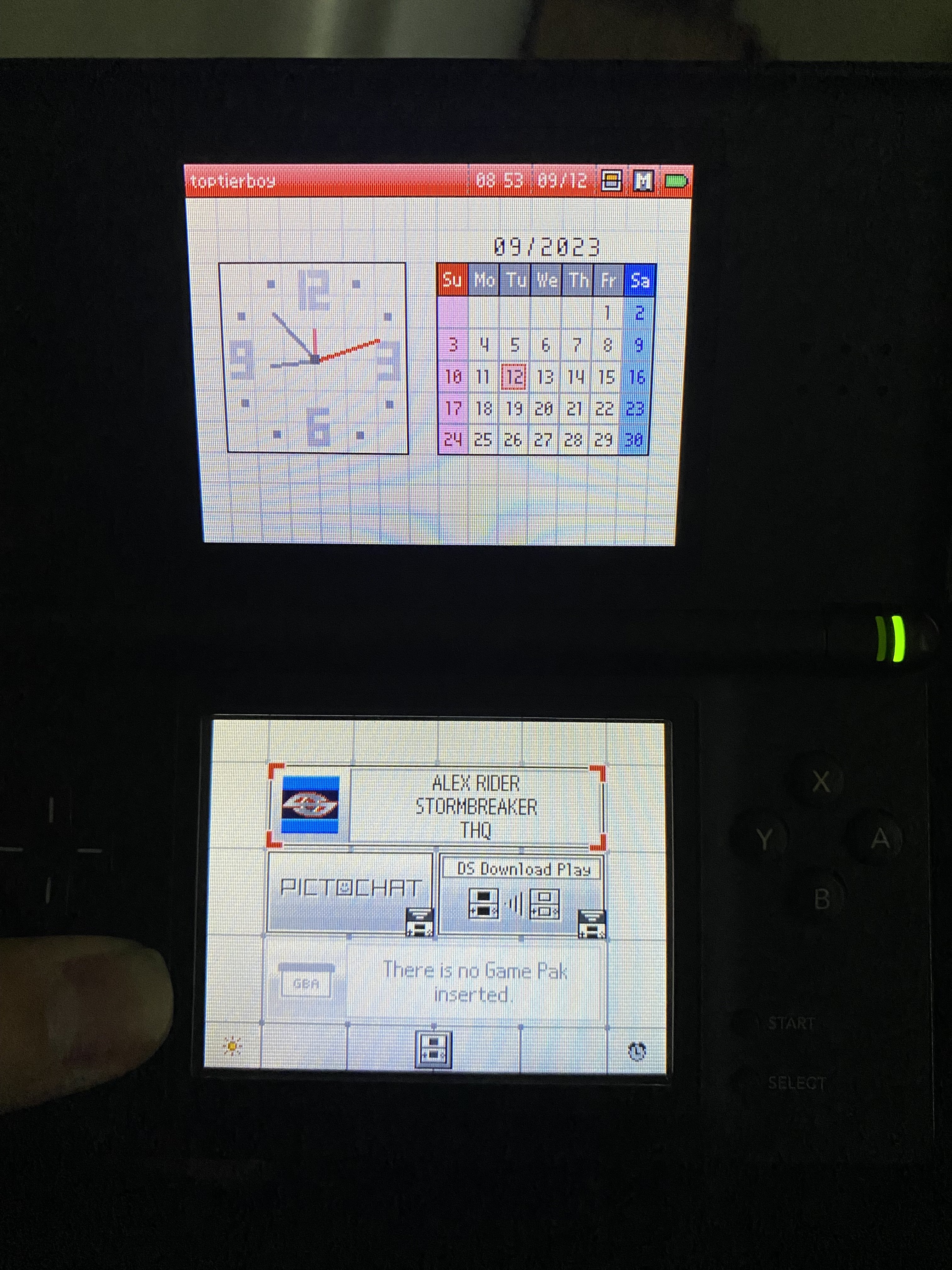

So I got a dstwo+ and I’ve noticed I have major issues with my ds lite reading it at times. I’ve tested my regular dstwo 2 in 1 with 2 different sd cards and both worked perfect on the dstwo 2 in 1. However both sd cards give me issues with the dstwo+ so I’m sure it’s the dstwo+ itself. I’ve tried cleaning the dstwo+ with isopropyl alcohol 91% and rubbing it with a glasses cleaning cloth. I finally managed to get it to work after deleting all the files and redownloading the firmware and eos for the dstwo+. I’m scared it’s going to stop reading it again however so does anyone have any advice on what I could do? I posted a picture showing when it reads the card but the problem is when I’m playing the games they will randomly freeze and then when I eject the dstwo+, reinsert, and turn on my ds lite the ds lite doesn’t read that cart (the Alex rider icon doesn’t show up)
So yeah it just froze on me again lol

Its obviously not a DSTWO+, rather, its a different DSTWO revision. Have you tried a different SD card?

I’ve made sure it had the update and eos already and it still freezes and then I have fiddle with it until the dsl can recognize it’s in the slot again
