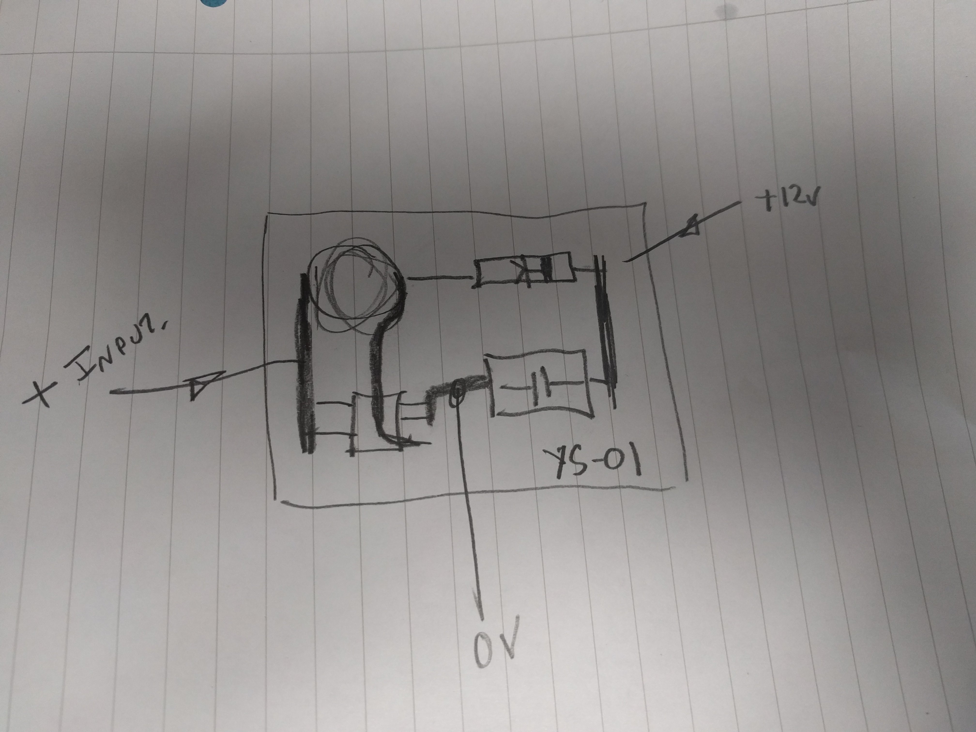

Is this diagram similar to your board? I have a couple of these I got from AliExpress but I have not tried yet.
You can try write the link with some spaces in it.

It is similar but not the same.

That is the exact board in my diagram. I have this board but I have not yet attempted this way of doing the mod.
Double check the photos and make sure all is exactly the same did you cut the trace?
