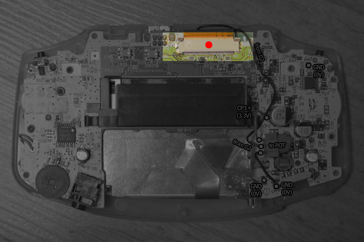

I just assume your description so maybe I'm wrong, but I think the problem might be occur by LCD cable port on the GBA board got loosen in center.
Try put some force with finger in the center that I marked red dot, and see if screen changed. BTW if this IS the problem, it's very hard to fix.
Thanks for the suggestion! I guess it does look like it's petruding a bit in the center, unfortunately I don't really have the know how to have it on while opened, but I could try to figure out a way to keep pressure on it while closing it.
Judging by the photo, would you guess that is the problem?
*edit*
Okay so I don't think that is the issue after testing a bit. My biggest fear would be the screen is faulty, but I don't really think so. Could it be the power switch? It has the classic flickering of the green/red light going on.
