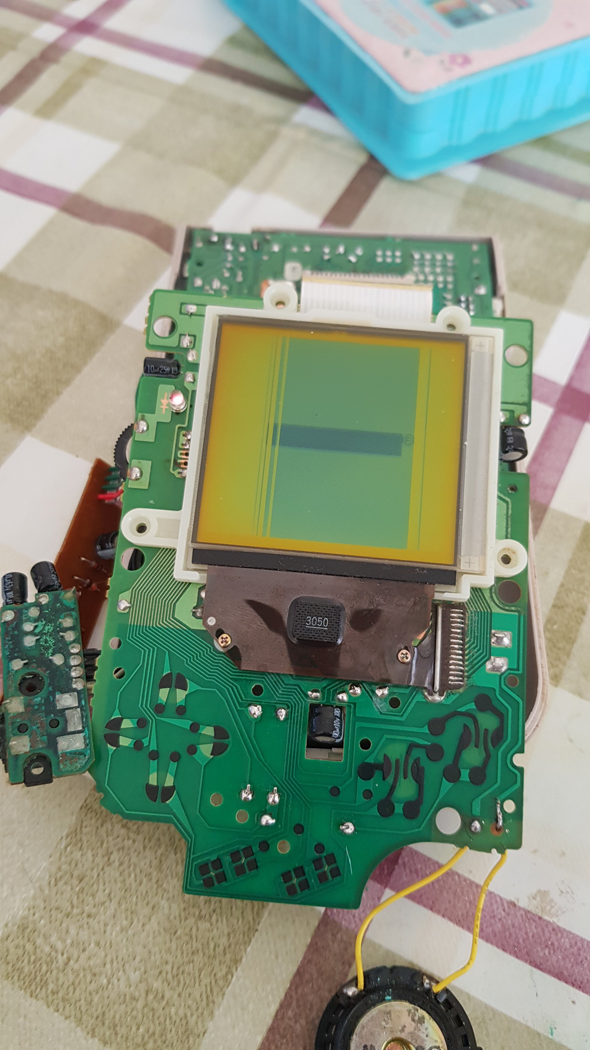

We have life!!
No sound, might be the speaker or linked to the audio board, I do have a spare so might just swap that first as it looks a bit rough!

We have life!!
Congrats! Just re solder the speaker to the cables to see if it's the speaker what's causing the problem.
On a second note, that screen has dead pixels. Reheating the soldering pins of the screen (the pins that are covered by a black strip on the back of the screen) should fix the problem.
yer i had a quick google, saw the lines down the screen could be fixed, that will be the next task.. :)

Right so I have fixed my lines down the screen, retrobriting the console, all good... No!
Decided to put a game in, does not load? Just shows a black box, like when you turn on without a game in.
A few of the solder joints on the cart looked a bit rough, most took fresh solder but a few at the end wouldn't so got my heat gun out and removed from the board, cleaned all pins and contacts put back on, soldered, tried a game, still not working?
Got my multimeter out and checked each pin to its test point, all beep? (in pic below).
So could it be one of the chips on the board? looked close and they have there names next to them so is it worth swapping the DMG Cpu, or any other ideas what it could be?
I really thought I was nearly there! :cry:
