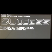

Use next steps to test everything:
  • Download the test payload https://gbatemp.net/download/fusee-test.38122/ and inject it to the console, if the next screen is displayed, your injection method, cable and port are working fine.
  • Download the test payload and inject it to the console, if the next screen is displayed, your injection method, cable and port are working fine.

Thanks, this is really helpful, downloaded and ran the test, got the same screen and with a timer.
