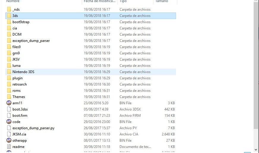

so i have and old 3dsxl whit CFW (b9s and luma) that was working properly one moth ago, but today i decide to play some ocarina of time and surprise the 3ds dont boot i cant even go into godmode as soon i push the start o select button the blue led go off, and if i try to boot whitout the SD card the same some 5 or 6 seconds of blue led and off again. i dont know what to do any tips?
PS i added a screen of my SD files

Your SD card might be corrupted, check it with H2testw. If it comes back as corrupted get a new card, and just put on a freshly downloaded boot.firm on it and see if your console boots. If the card comes back as fine, try formatting it as FAT32 before putting your data back on.
the SD its okay i just formated it again in fat 32 and also put the files in it again, same problem no boot, just the blue led for 5 seconds or instaOFF if i try to boot whit start or select presed

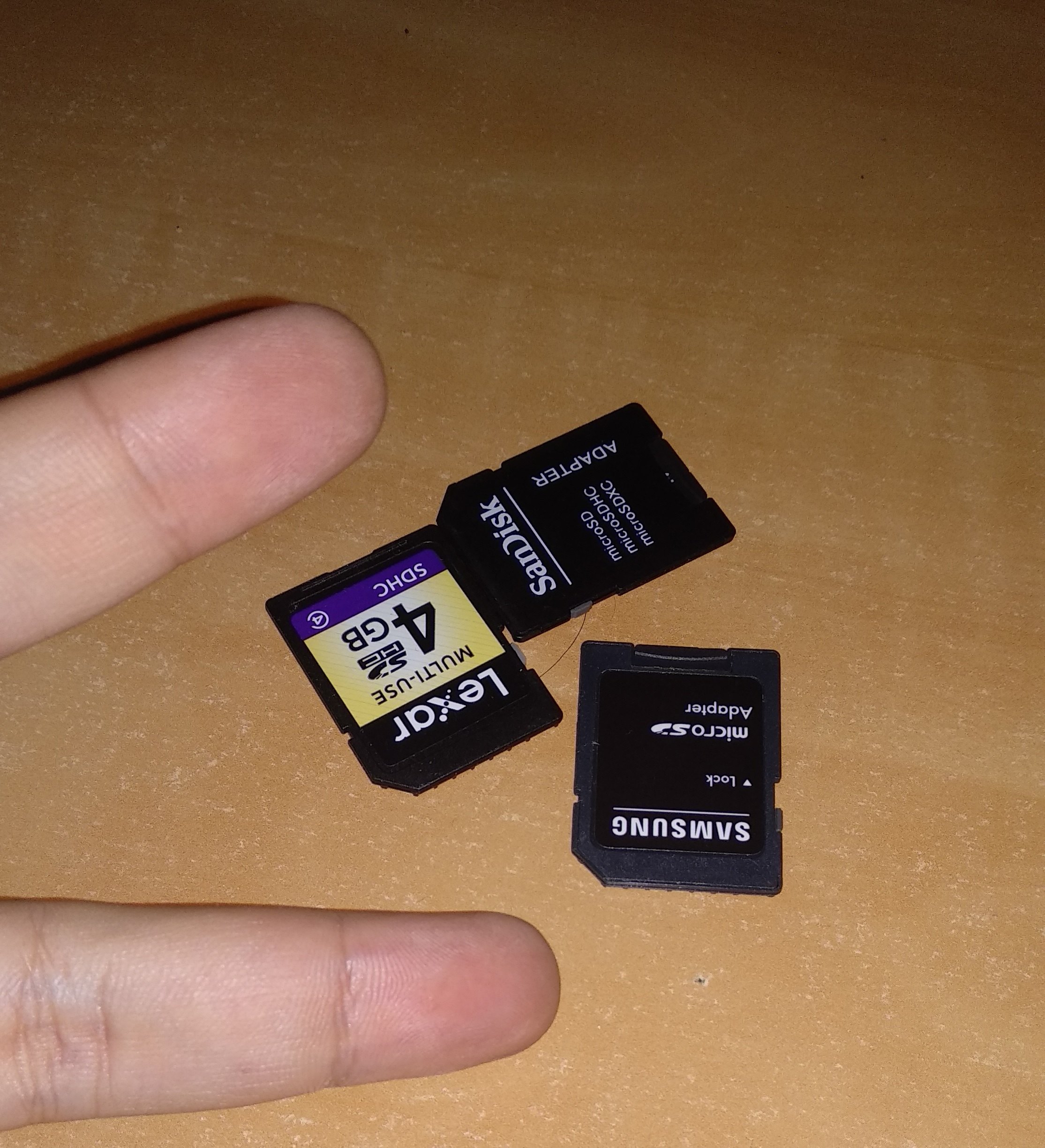

im running the test but i have 3 SD card with backups of the same data of the "corrupt card" and i have the same problems with the 3 card so i doubt the SD its the problem T_T

That Lexar one looks to be in the slider lock position of Read-only. Another thing you can try is the battery removal and reinsert trick (may or may not work). Try that battery trick and start the 3DS without an SD card.
