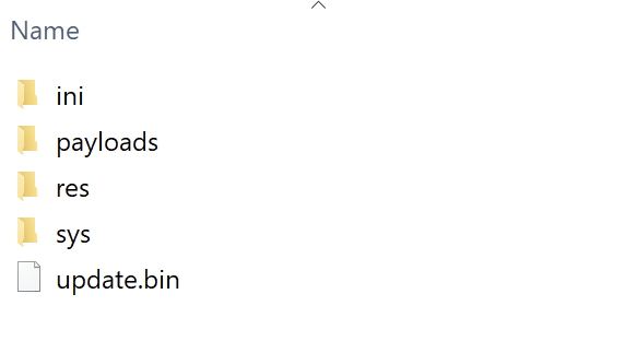

trying this now, but I'm not seeingb ootloader/hekate_ipl.ini
was there another `payload.bin` before you rename the `hekate_ctcaer_5.7.2.bin` to `payload.bin`?
That pack seems to include signature patches and tinfoil, so I would not use it with a to go online.

The payload.bin is also just hekate, and unless the modchip uses the boot.dat and boot.ini for some reason, that should not really make a difference, but he could try putting the payload.bin, boot.dat and boot.ini from that package on the sd-card and check if it makes a difference.

following up, I missed the part about renaming to payload.bin so that was on me.
but now I booted it up and when i try to open ACNH I get this error: 2123-0011
