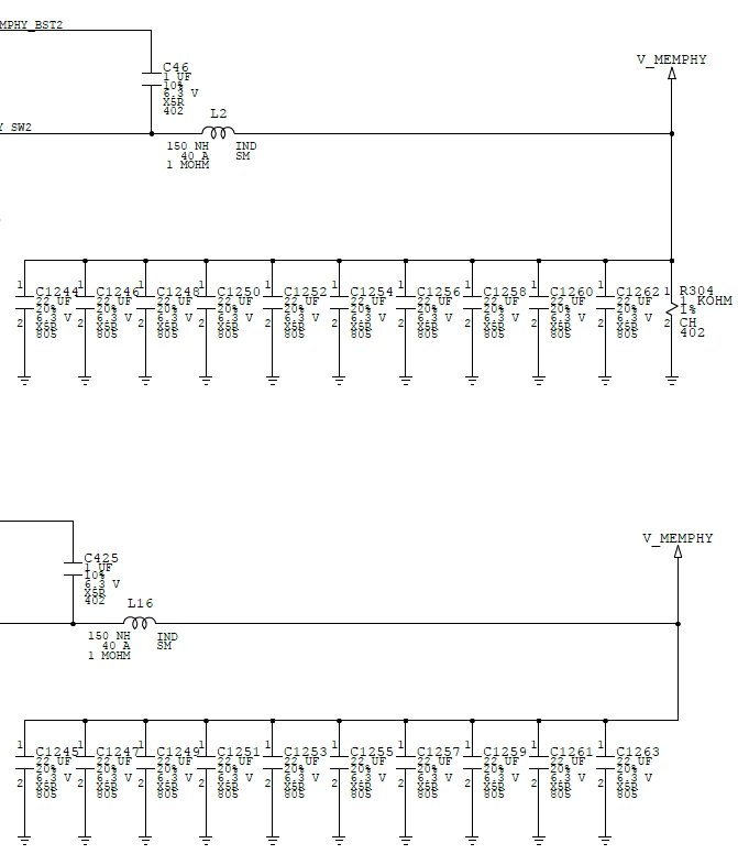

Hi everyone, I have a couple of components missing on my Xbox one X main board, and I need some assistance in identifying the parts as well as where I can obtain them. I have taken a photo of the affected part of the board. If anybody can identify these components and reply back, I would greatly appreciate it. I have attached two copies of the photo one identifying the areas in which the parts are missing.

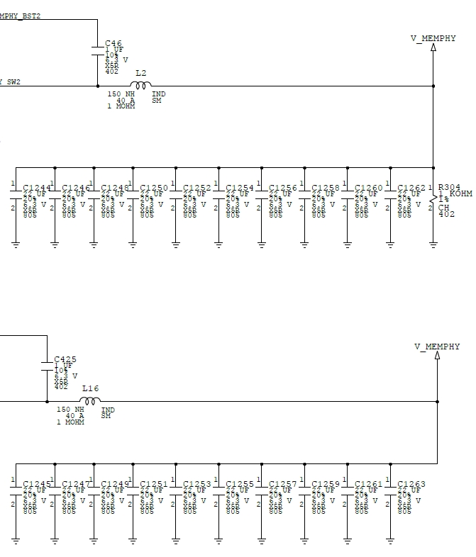

attached below is the schematic for this part of the circuitry, the C529 cap that is not on the picture is of the same value as all other missing caps (22uF/6.3V/20%, X5R, 0805). Can source the components from places like digikey or mouser, or from donor motherboard
Thank you for the information. I was able to find the the surface mount capacitors at digikey /en/products/detail/samsung-electro-mechanics/CL21A226MQCLRNC/3888071 but I can't seem to find the R15 inductor. I guess more specifically I can't find and ensure I have the right Capacitance, Tolerance, Voltage - Rating, Temperature Coefficient, ect. Can you assist with that?
