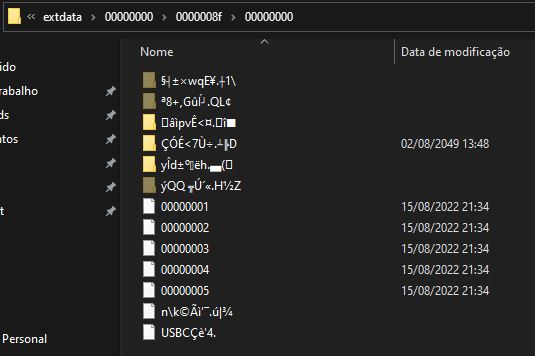

Yep. It got that. But looking further upon the folders I found this. Looks like the sd is invalid after all...
Yeah that looks pretty bad. Don't think that's recoverable. That's one reason why I use JKSV to dump all my saves every now and then, and keep the files off of the 3DS.
