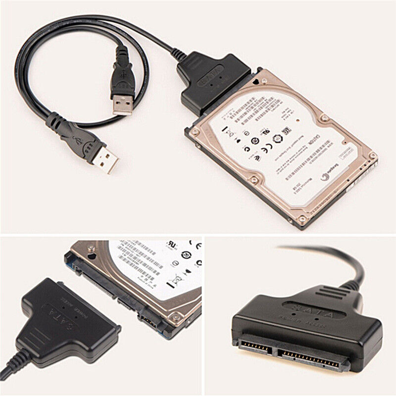

_ the enclosure used likes to put hdd to sleep
Try & use a plain-Jane HDD to USB adapter with an already "Y" cable incorporated (extra power).
"Y" cable can help with low Wii USB power to suit your HDD. These USB adapters can come with "Y" cable or as a single.
You may need to remove your HDD from it's original enclosure & implement with your newer adapter. A cheap option.

What adapter do you specifically recommend? Hdd to usb with Y cable? Do you have a link by chance? Ty
Ebay or Amazon (or the like).
I can't guaranty it will work 100%, but to spend a few bucks, it could be worth it :)

_ hdd is not getting enough power from the Wii and I need a Y cable (unlikely since we're talking about the Wii and not the Wii U but who knows?)
Ok, the y-cable is not necessary, but it's worth a try if you're having power issues. When you get one, make sure the main usb cable goes to port 0 and the other (adjacent) smaller usb cable goes to port 1 mainly for power, the hdd will not work correctly if you swap these cables.
