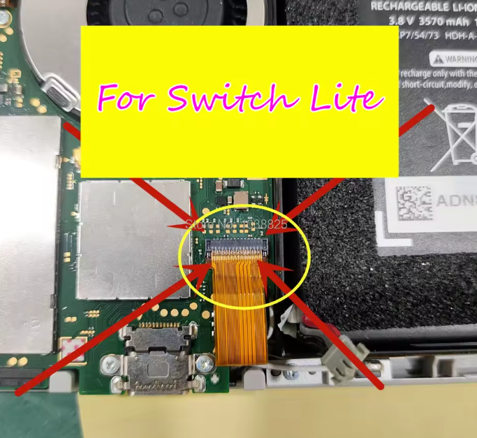

I finished installing the mod chip safely
However, the left analog stick only moves up and down and doesn't work left and right. Replacing the analog stick and film didn't solve it either.
Just a guess, I think there was some damage when taking out and putting the film in this socket in the picture. (The left ground part of the fixture socket is slightly damaged)
After installing the chip, the screen didn't even come out at first, but I pressed and fixed this socket well again, and it was output.
I think there is definitely a problem with this part.
(I think it's affecting the left analog stick as well.)
The problem is that you can't see the socket replacement video in this part on YouTube.
If you shoot the hot air fan from the bottom, all the small elements will fly away.
Any good videos or good tips?
I will be ordering this part soon.
