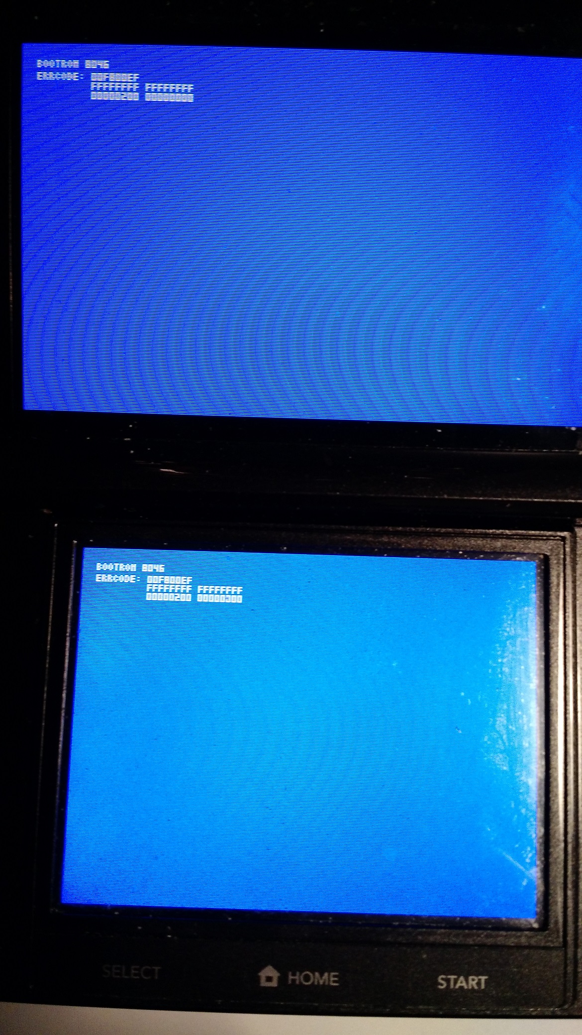

Well hello again everyone. Been almost six months now and I haven't really tried anything to fix my system beyond what I did when I originally made this thread. But something amazing happened a hour or so ago. I was reading a thread about the 3ds on a different site and just for the hell of it I opened up and turned on my old 3ds. And what do you know, my previously hard brick 3ds has magically turned into a soft bricked blue screen 3ds.
BOOTROM 8046
ERRCODE: 00F800EF FFFFFFFF FFFFFFFF 00000200 00000000
So now that I actually have some kind of idea what's wrong with the thing. What are some of the steps I should take next? I'm seeing lots of info about ntrboot which means I definitely need a flashcard now. Are there any specific threads I should read to prepare? I am kind of afraid to turn it off now in case it reverts back to it's old state. But if it is this flaky and switches back a forth between hard and soft brick then that definitely means it's some kind of component on the main pcb right?
BOOTROM 8046
Try the NTRbootHax , you might be able to fix it.
BOOTROM 8046
If the o3DS was left alone sitting attached to the charger all those months ago and turning it on now reveals a bootrom 8046 error, this is 99% certainty a hardware based brick as stated before caused by overcharging or fried components.
You can try the various previously mentioned software debugging ideas, but I have doubts any of them will fix it.
Nintendo currently has refurbished 3DS/2DS models on sale.
Or, fixing it yourself by replacement the o3DS motherboard.

I just looked at the bootrom error codes (https://www.3dbrew.org/wiki/Bootloader) and your error code doesn't match any of the listed. The most similar one suggest an issue with the NAND connection. (Would make sense as the NAND has a limited number of R/W and you had it powered on for so much time.)

Well finally tried it tonight. I tested the card in my old ds to check and see if it worked and everything seemed fine. Opened the card up, flipped the switch, threw all the files on it, placed the magnet aaannnd, nothing. All it dose with the magent in place and the buttons held down is turn on for a second or two with a black screen and then shuts itself off. I mean it's something different at least but it's obviously still bricked. Turn it on normally and it still dose the old blue screen. Is it turning on then back off again by itself a sign of me screwing up with the files or something?
Seems to me this "black screen" thing is something more farfetched and complicated than a mere brick
you could have fried the 3ds's innards and particularly those parts accountable for a proper boot up. hence you might need to swap the motherboard entirely. or go for an used 3ds if you can afford it.
