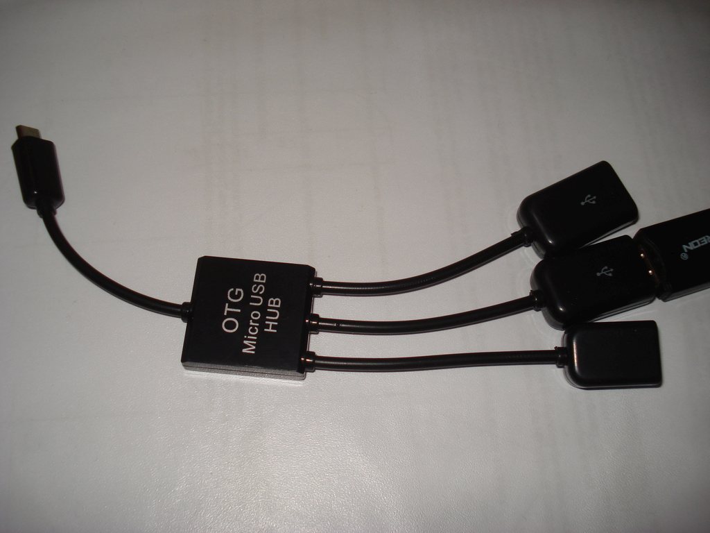

I have seen this adapter on other web shops and it said there that the micro USB port is only there to power the USB devices connected, it will not charge your phone (or power your SNESC).
From the article description:
The mini-slot for power supply is unfortunately not suitable for charging phone/ tablet.
both links are the same usb to go cable!
and when you would read what i wrote!
i have this cable and it work!
look at the internet
the internet is great!
i need no smc/sfc to sfrom converter!
i need a sfrom to smc/sfc converter
Are you sure you don't have the one with a otg/charge switch and three usb A ports?
are you thinking that i am a idiot and can not count or dont see the switch?

I think people often just glance at things and the cables look rather similar. I wouldn't want to recommend a cable to people that says in the description that it wont charge. Your's might be a different make or the description might be wrong. I am only pointing out what the product description says. I bought the cable that I linked (with the switch) from another store for 1,84€ where it actually says that it'll charge the device and use the OTG ports if it's set to "charge", I just linked the amazon listing because it was the easiest to find quickly.

I confirm the new procedure is working ! USB pendrive succesfully recognized ! I used the OTG cable with switch. A switchless adapter was not working (console not turning on at all).
