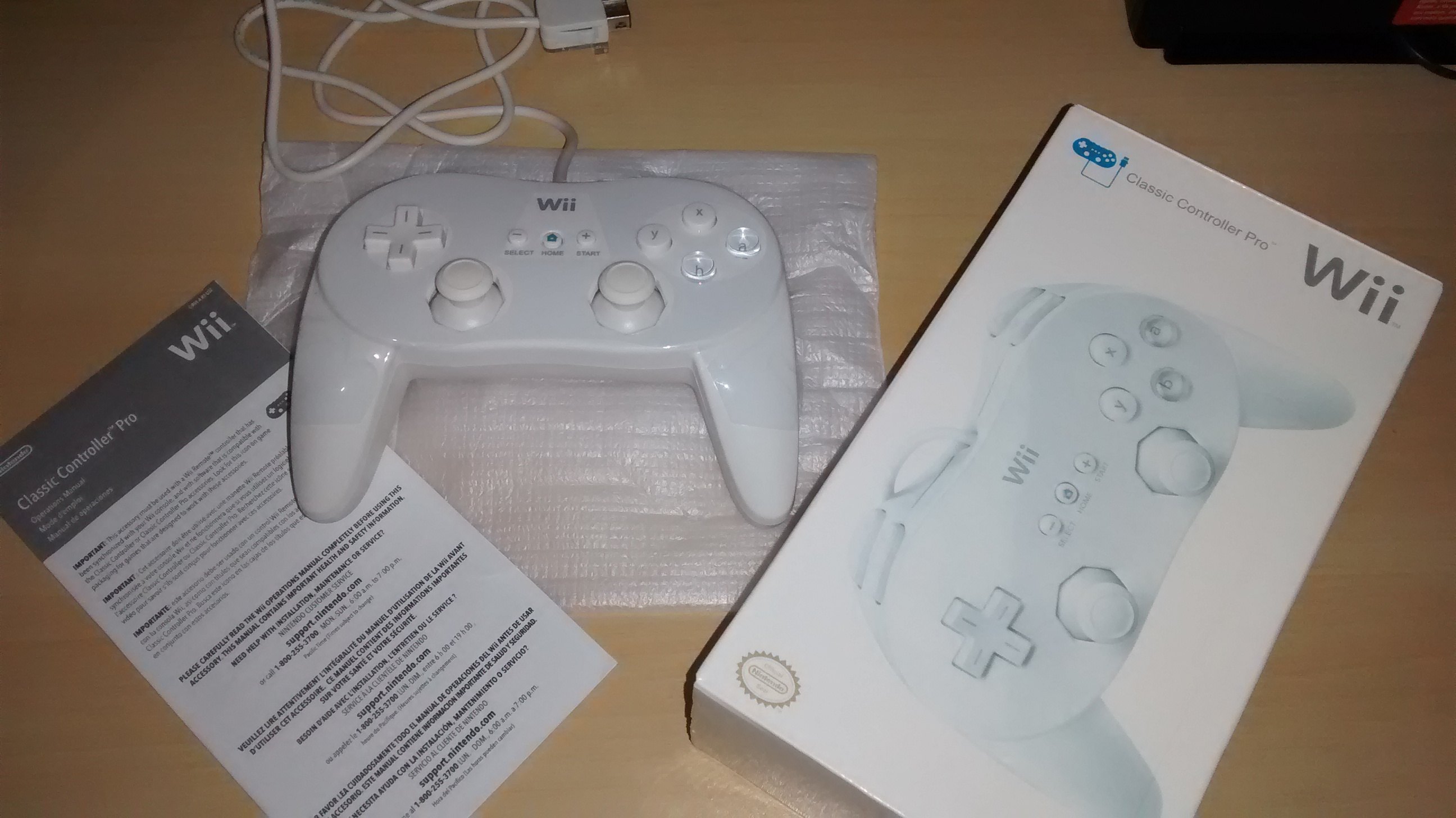

@Cluster , I've tried many times, but the problem persists: original Classic Controller Pro doesn't work here.
Is it possible to be a fake one??? Please, check the picture.
I have that controller and it works. So something must be up.
Yours has a different shade of white around the buttons and the logo, also the Wii logo seems darker. Does it say Nintendo on the back? Regardless it should work with 2.14 if it is not broken.
I don't know. But if it worked before it should work now.
The controller still have a plastic film on it. There's "Nintendo" logo on the back.
Is it possible that I've forgot to install something? CloverShell, CloverCon? I don't have any idea.
Haha OK.. thought it looks a bit off. In that case yours looks legit and the same as mine. If it worked before I don't know what to tell you. Did you check it with a previous version of Hakchi (you still could)?
Edit - Better yet uninstall Hakchi completely from your NES mini (back to stock) and if it doesn't work yours is broken. These things should work straight out of the box.

Weird thing, because the controller is working fine, just right now, on my Wii... :blink:
if it was working before then no reason it should just stop working. Sometimes after I add retroarch my controller doesn't work. But all I have to do is turn it off and unplug it then turn it on and plug it back in.
