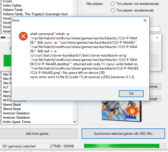

Not sure about this error.
I updated retroarch, copied dump, config, user_mods, and games folder. reinstalled custom kernel
No space left on device... NES Mini's internal flash memory is full. Seems like there are something really large in rewritable memory. It can be some mods (retroarch's assets pack?) or save states. Old SNES core using very large savestates.
Read the error message... there is not enough space on the disc to store the data... you may have used spaced from save files, mods, etc... delete some games or clear your save files... then the upload will work...
You can use clovershell (https://github.com/ClusterM/clovershell-client/releases) tool to check filesystem and remove large files. But it requires basic Linux knowledge.
Deleted couple of bigger games. Also using mame2003. Might switch to mame mini core.
You are correct. I deleted some larger game roms. All good.
