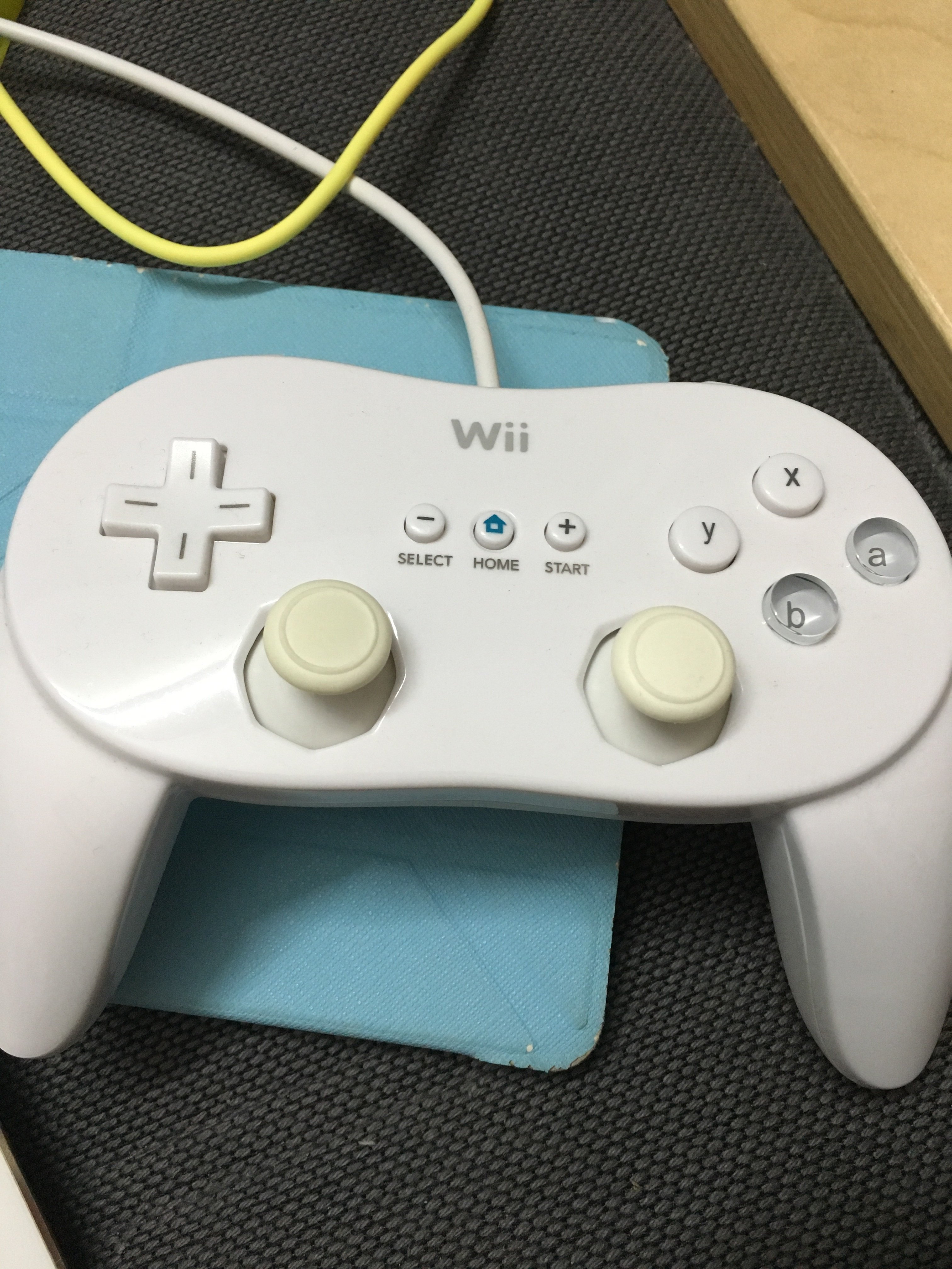

If it's not working it's either broken or unofficial.
I'm sure it wasn't broken cause I can use it on my wifi
Does it have Wii printed on it or is it blank?
Hmmm might be some third party ones

The driver is open source. If someone figures out why they aren't working (Maybe an I2C bus addressing issue?) and patches in support, they could work. But for now, no. It's not a Hakchi2 or retroarch thing, they just don't work with the console at all,
