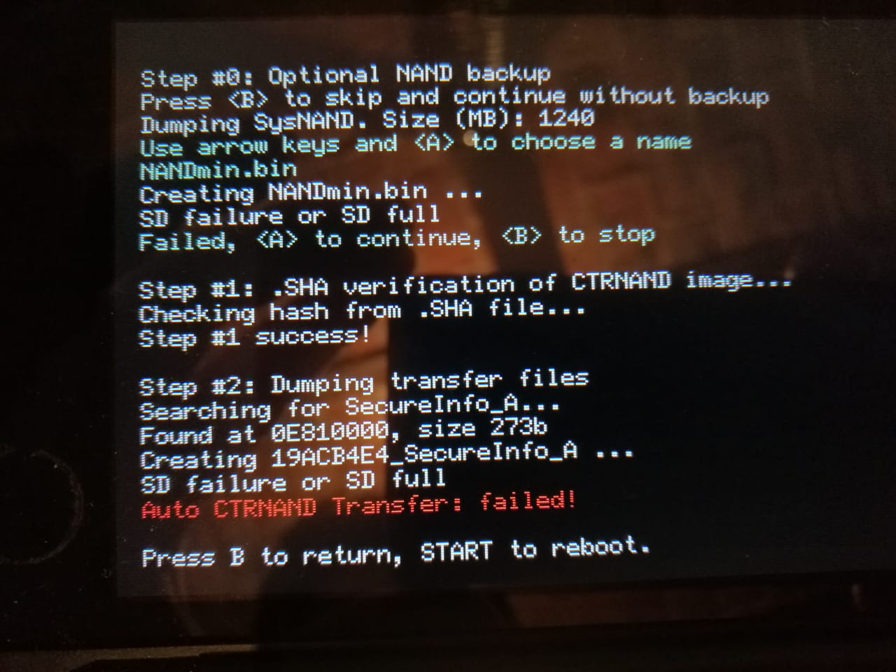

Here is what i get

That error looks exactly like the one I got on my USA n3DSXL that was region changed to JPN. Did you region change your n2DSXL before?
Edit - Nevermind. My error occurred in step 3 after CTRTransfer finalized.

Something is wrong with your SD card. Decrypt9WIP did not perform the CTRTransfer. In step #2, it was trying to make copies your essential files like movable.sed, LocalFriendCodeSeed_B, SecureInfo_A, etc.
I think the program needs more free up space to complete the flashing. Try using a different SD card (after it's checked in H2testw).

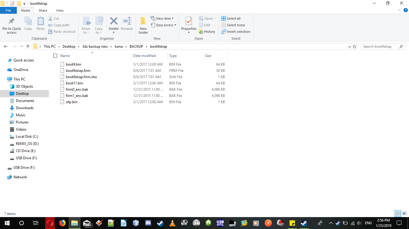

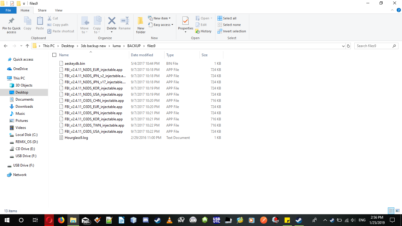

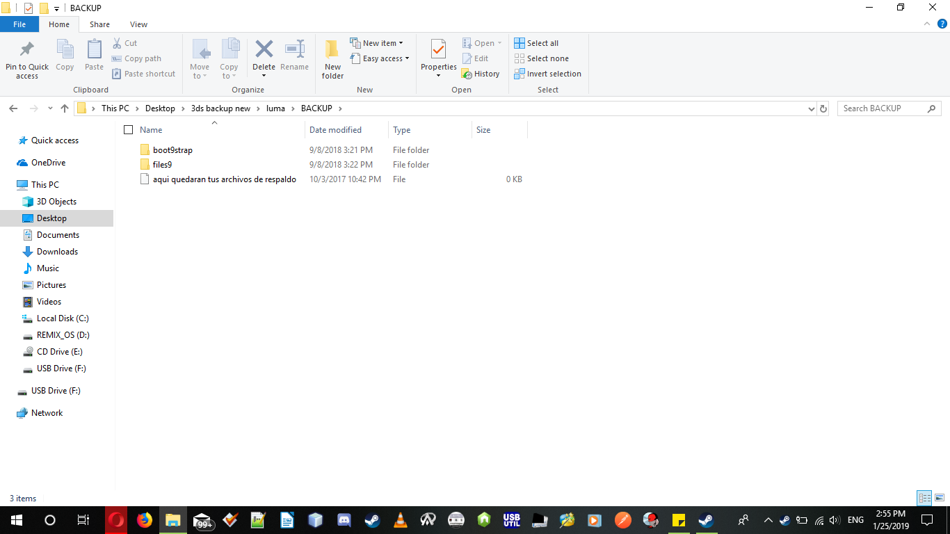

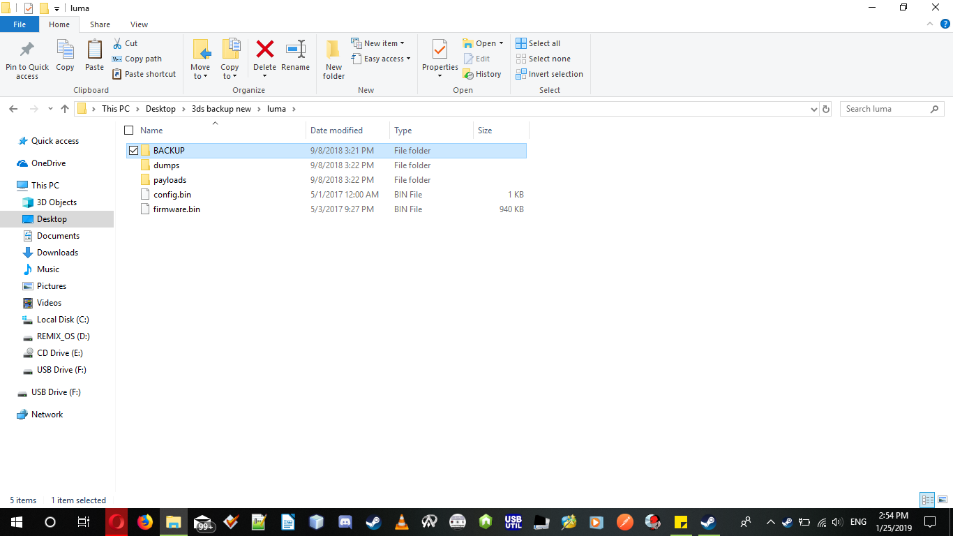

also.. i have a safe copy of all my files from when my 2ds was working correctly.. it's basically a copy and paste. the interesting thing is that i found a folder called BACKUP in my luma folder.. could it be a backup from the sysnand?? I'll send pictures
In the text it says "Here are your backup archives"
Here is what's inside each folder:
what do you think? can any of these files save my system?
-snip-
-snip-
None of those contain a clean copy of your SysNAND *.bin image. The only usable files are the firm0_enc.bak and firm1_enc.bak in the event you lose sighax (boot9strap)... This would not happen unless you have a bad SysNAND Restore (full), which again should never be used unless you have very particular reasons to:
