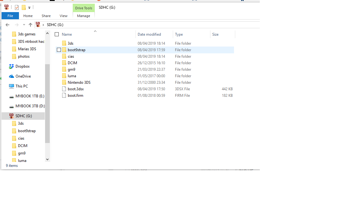

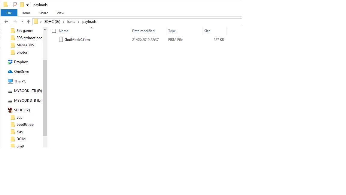

I am attaching 2 images of my SD files in case i missed something. In the root folder i have a valid Luma firmware as boot.firm
Any ideas to help me?
