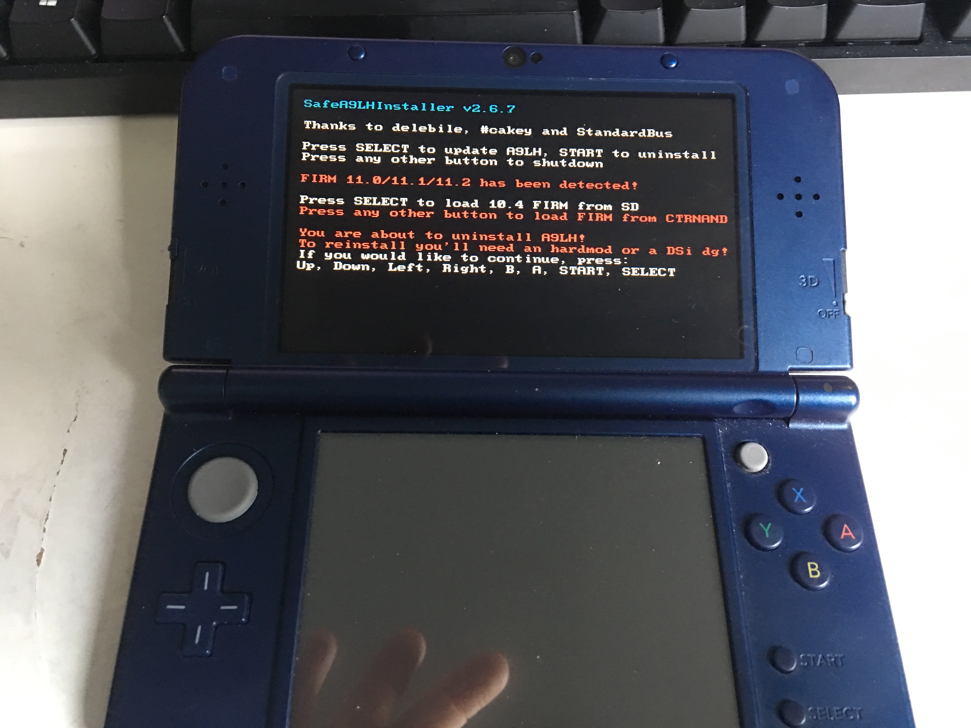

So I need to sell my New 3DS XL to original because I am gonna sell it, problem is, I thought by formatting the console and the SD card it would be enough, but now the console doesn't boot anymore, when I hit the power button the blue light flashes on and off and that is all.
Can someone tell me how to get it back to factory? Thanks !

Tried it doesn't work, I put on the SD the 3DS folder, the armloaderhax.bin and the SafeA9LHInstaller.dat files, but nothing happens, the 3DS LED flashes blue and nothing happens

has to be FAT32 64k.. cards higher than 32GB needs a software to format it properly..
Yeah the problem probably comes from there. It is a 64 gb samsung SD card and I just used the basic format tools, back at it and i'll keep you informed
For it to boot you need an arm9loaderhax.bin as mentioned above; take one from whatever you want to boot
Do i proceed? Will it make the 3ds back to factory?
