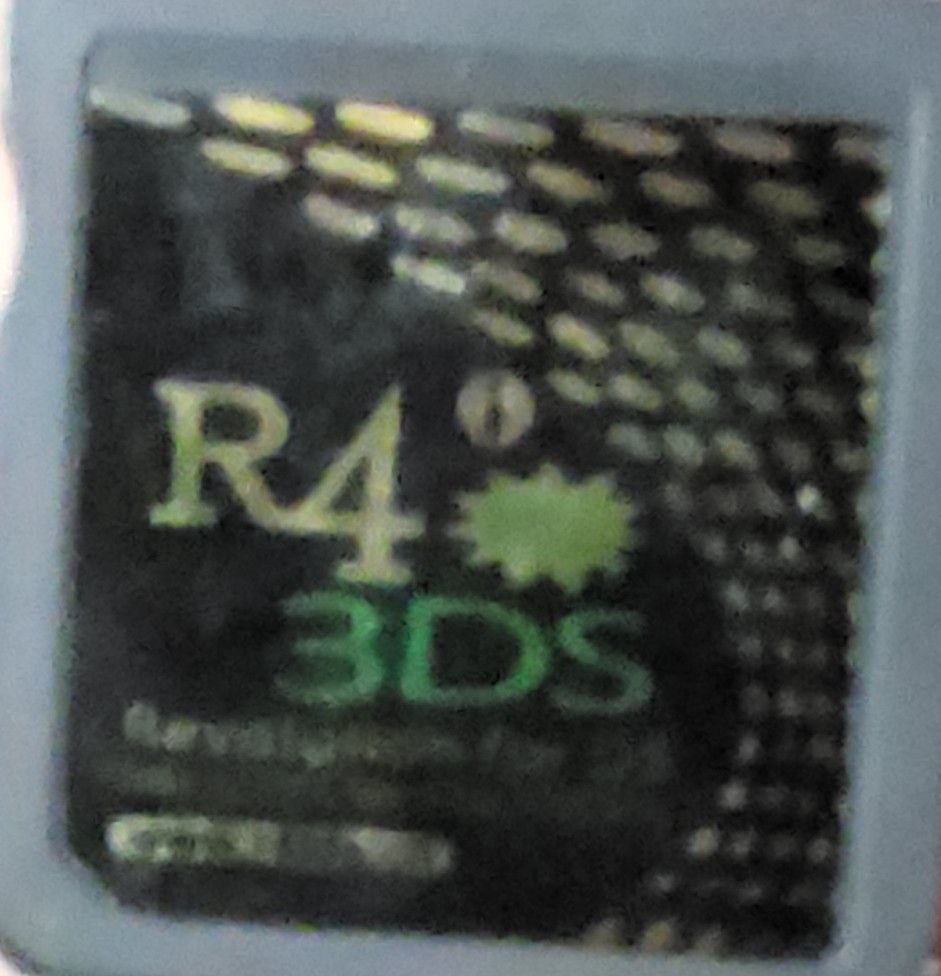

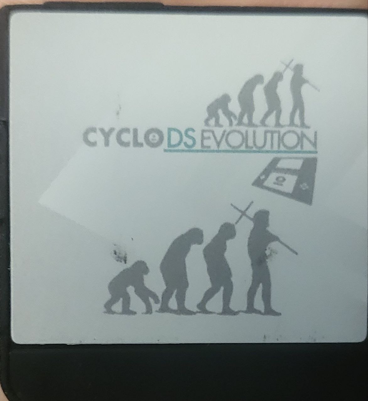

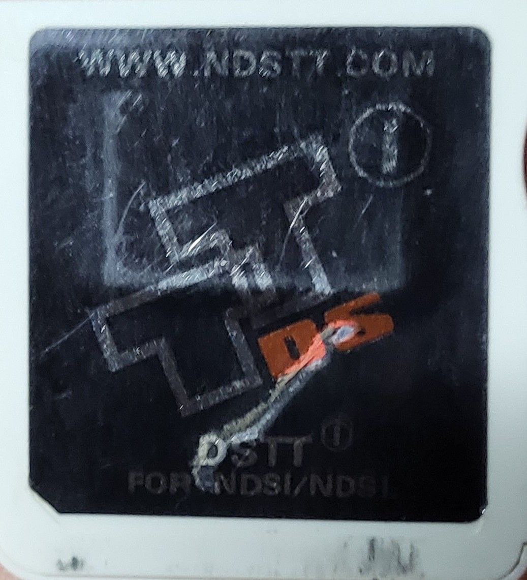

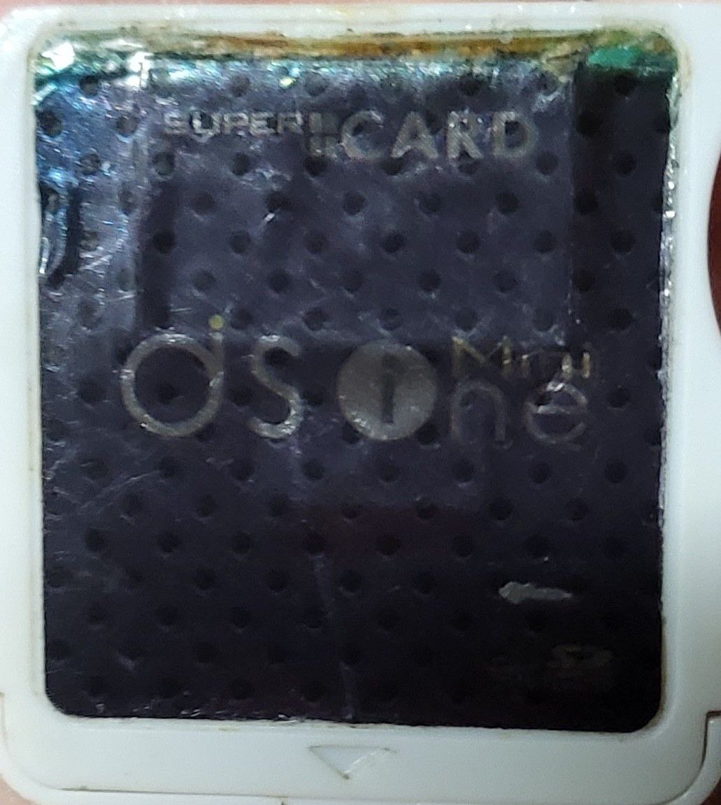

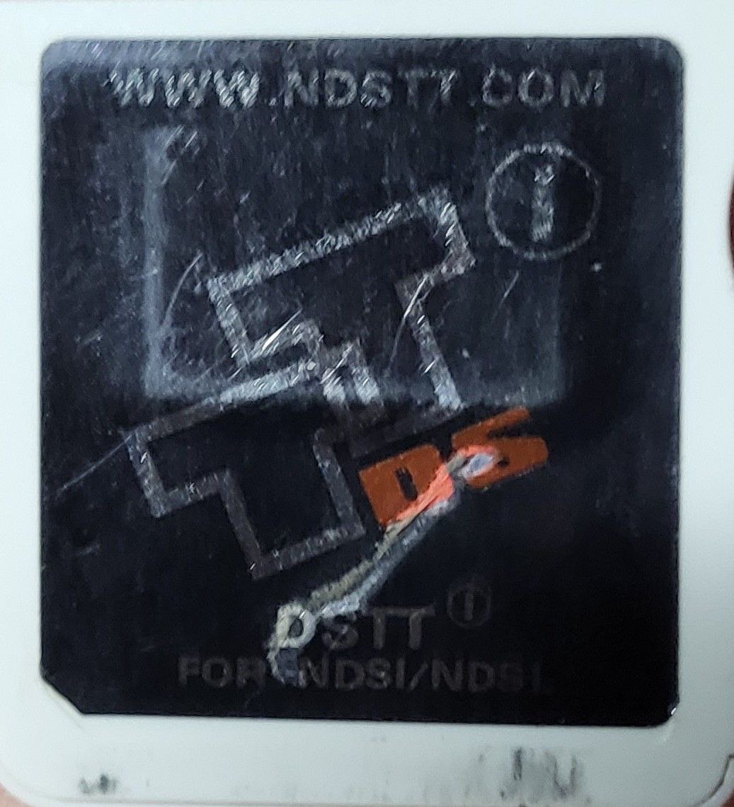

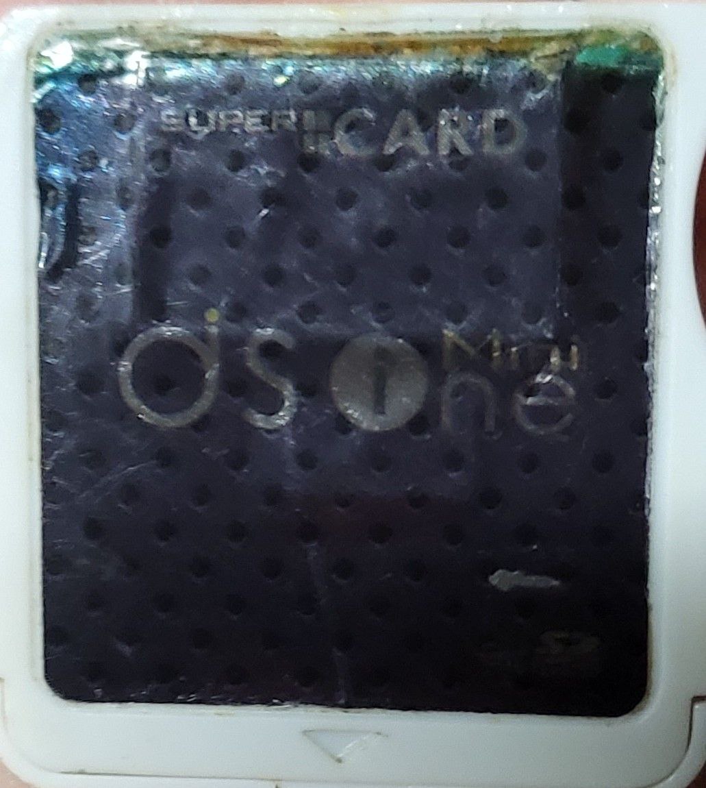

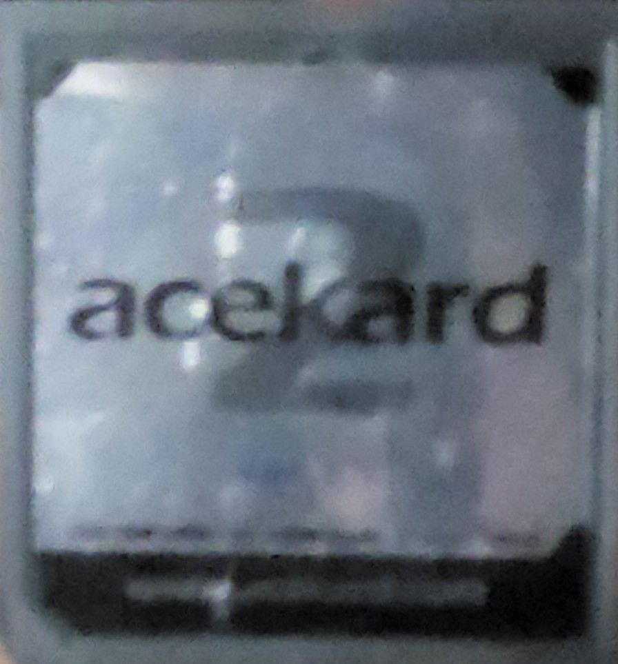

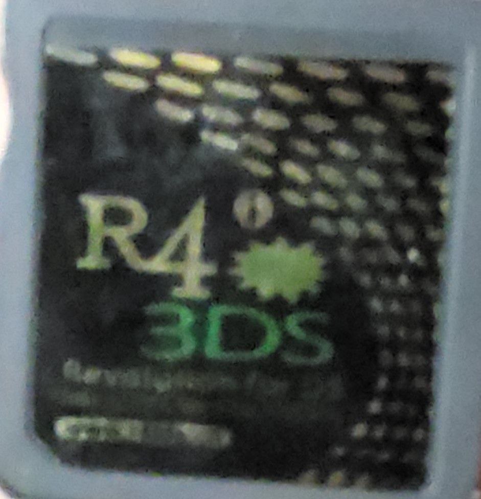

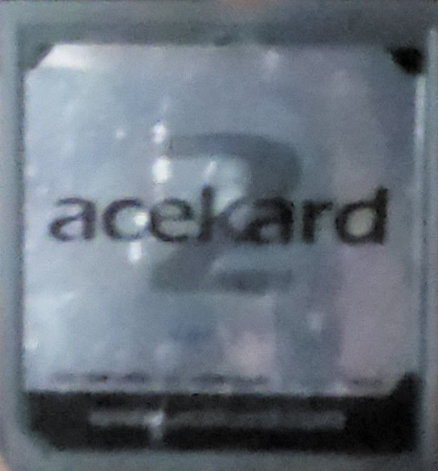

The more common cards like Acekard and R4 (at least, this model) don't work with the mod at all. They'll only play games at normal speed while its installed. I included the type of firmware(or kernel?) I'm using for each in case it ends up mattering.

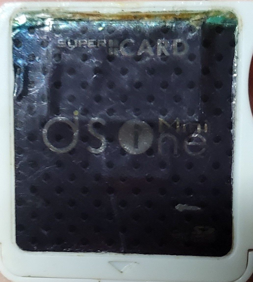

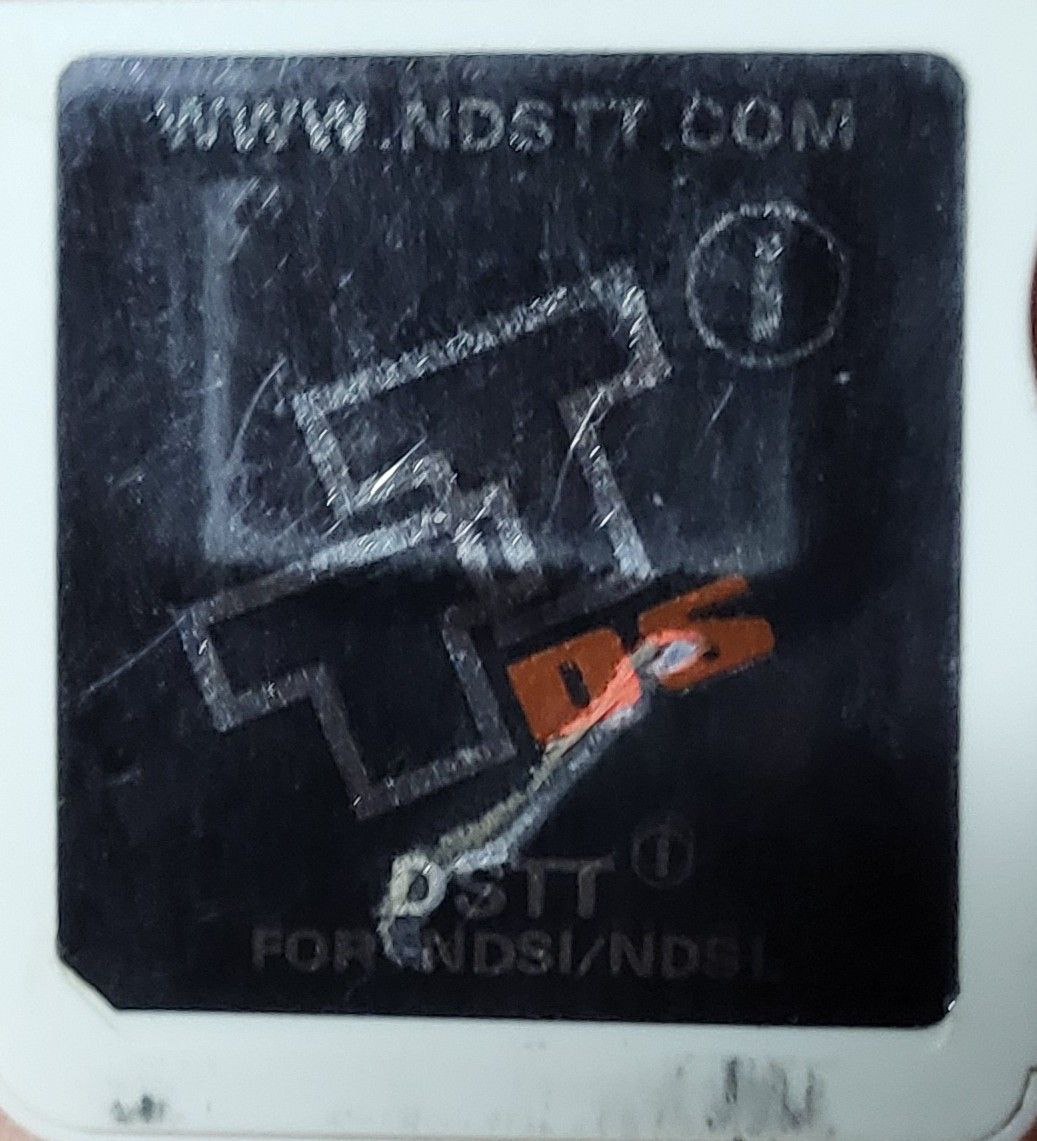

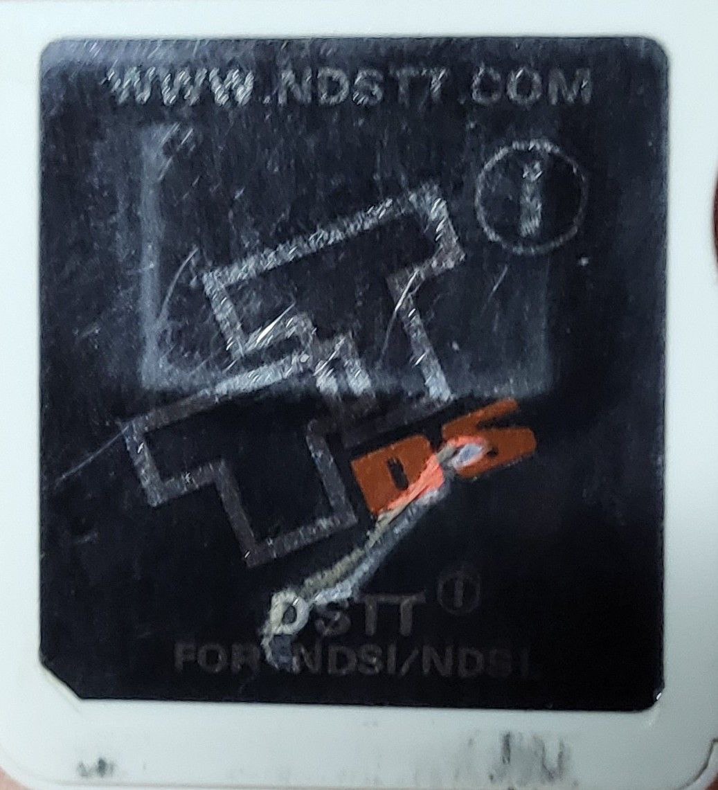

The DSTTi and SuperCard ds One i worked fine for me. They supported several DS games up to the ultra speed without issue. I'm curious why this is - maybe clones of these would work as well. Or maybe its the firmware that can be supported on the card. I may test a DS phat with the same cards at another time, but for now I just wanted others to know that its possible to run native DS games with speedup mods.

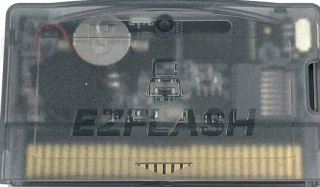

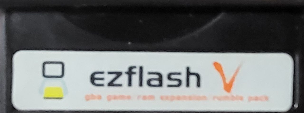

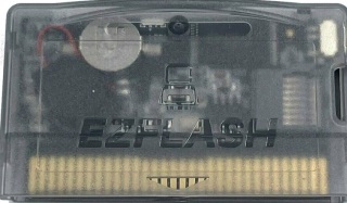

-I also did a test with my 2nd slot card Ez Flash V 3in1 launching GBA games with GBAExpLoader, but all the tests were the same for different DS carts so I think the slot 2 GBA compatibility only relies on the slot 2 card. The ez flash omega de on ds lite only worked partially.
[TABLE=full]
[TR]
[TD]
[/TD]
[TD]
EZ Flash V
(GBAexploader)​
[/TD]
[TD]
EZ Flash Omege DE
(slot 2)
[/TD]
[TD][TABLE=full]
[TR]
[TD]placeholder[/TD]
[TD][/TD]
[/TR]
[/TABLE][/TD]
[TD][TABLE=full]
[TR]
[TD][/TD]
[/TR]
[/TABLE][/TD]
[TD][TABLE=full]
[TR]
[TD][TABLE=full]
[TR]
[/TR]
[/TABLE][/TD]
[/TR]
[/TABLE][/TD]
[/TR]
[TR]
[TD]
PSRAM Mode GBA Standard Speed (1x)
[/TD]
[TD]
Stable
[/TD]
[TD]
Stable
[/TD]
[TD][/TD]
[TD][/TD]
[TD][/TD]
[/TR]
[TR]
[TD]PSRAM Mode GBA Variable Speed (.66x, 1.3x)
[/TD]
[TD]
Stable
[/TD]
[TD]
Stable
[/TD]
[TD][/TD]
[TD][/TD]
[TD][/TD]
[/TR]
[TR]
[TD]PSRAM Mode GBA Optional High Speed (1.7x)[/TD]
[TD]
Broken
[/TD]
[TD]
Broken
[/TD]
[TD][/TD]
[TD][/TD]
[TD][/TD]
[/TR]
[TR]
[TD]NOR Mode GBA Standard Speed (1x)
[/TD]
[TD]
Stable
[/TD]
[TD]
Stable
[/TD]
[TD][/TD]
[TD][/TD]
[TD][/TD]
[/TR]
[TR]
[TD]NOR Mode GBA Variable Speed (.66x, 1.3x)
[/TD]
[TD]
Stable
[/TD]
[TD]
Broken
[/TD]
[TD][/TD]
[TD][/TD]
[TD][/TD]
[/TR]
[TR]
[TD]NOR Mode GBA Optional High Speed (1.7x)
[/TD]
[TD]
Stable
[/TD]
[TD]
Broken
[/TD]
[TD][/TD]
[TD][/TD]
[TD][/TD]
[/TR]
[/TABLE]

That being said I’m surprised you had any luck with the gba ezflash cart and it. This mod would always instantly lock that thing up on me
Were you trying with a ds or gba? And on ez flash omega or definitive edition?
