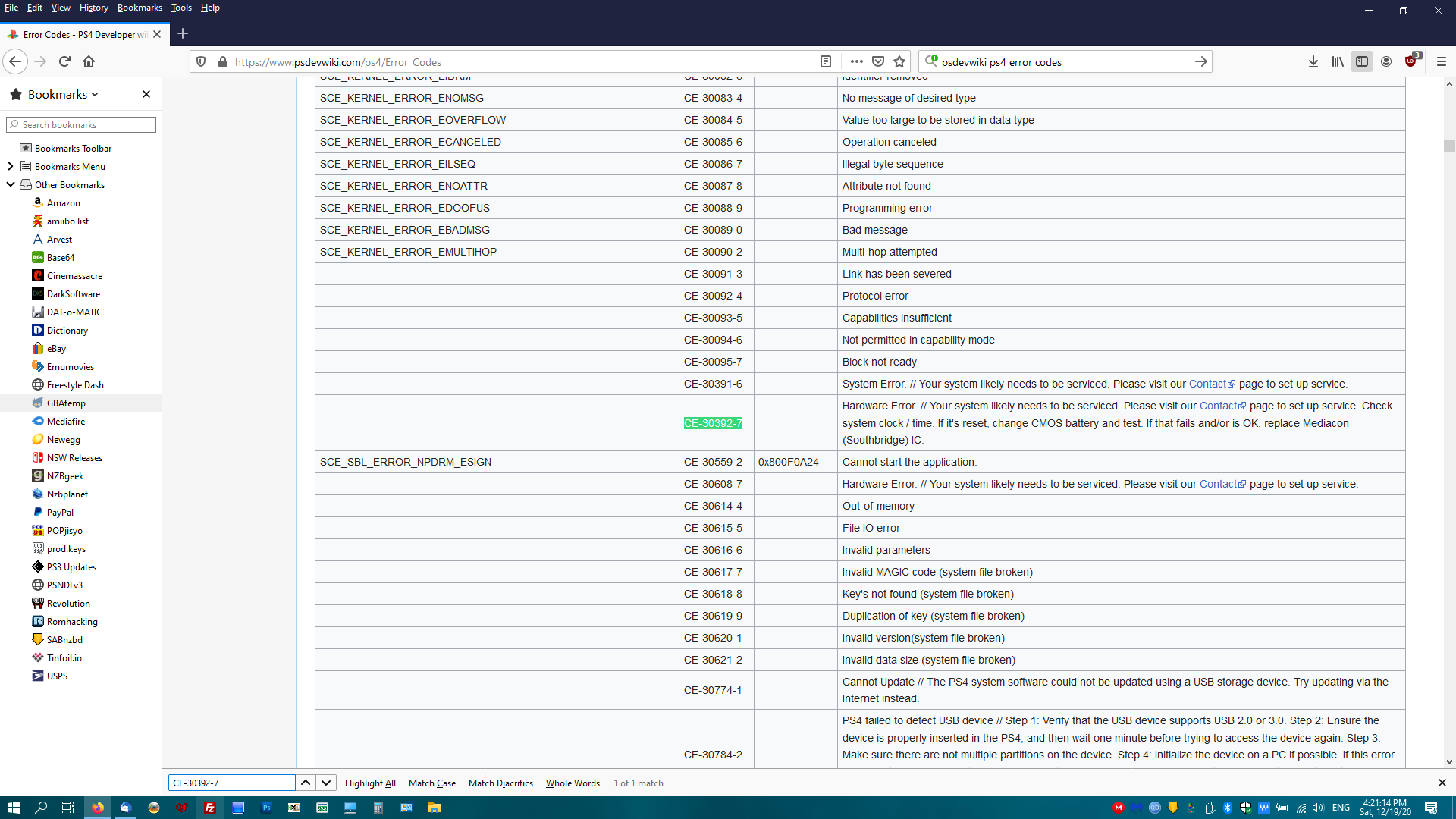

btw, I got this when looking up the error code:

I wouldn't rebuild the database unless you have a copy of your app.db. all fpkg games will disappear if you do. however, rebuilding the database does fix more than database errors from what I've seen.
Yes my cmos battery is dead for a long time, i always set date/time manually and it hasnt been a big problem
I hope on 7.02 , cmos battery won’t block me...
I have changed the CMOS battery, now I have a new error CE-30391-6
