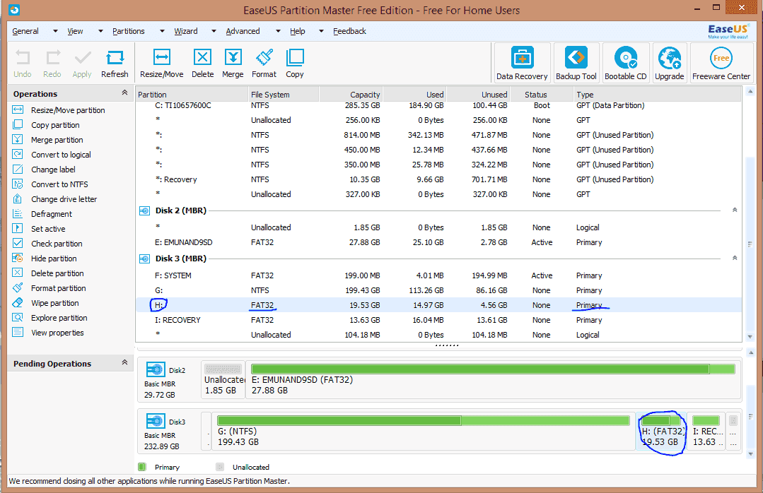

can you screenshot what your drive looks like inside the program you are using I want to see how you have it partitioned?
underlined one is where my GC games are stored
[^Blark^]
Okay well then it wouldn't be the "first" partition on the drive its the 3rd.
you have on disc3:
F:system (1st)
G: ? (2nd)
H: GC 3rd
I:4th
(drive H:) has to be where F: is and set as primary so its first on the drive.
i would go ahead and backup your wii games and gamecube games and any other files you have on there. format the drive so you have 1 partition.
I'm gonna go out on a limb and say that the hard drive you're using is a recycled hard drive from an old laptop or something, correct?
Nintendont probably can't detect the partition your GC games are on because there are two other FAT32 partitions.
Delete the SYSTEM and RECOVERY partitions on the hard drive, you're not going to need them considering they're used only in (OEM) OS drives and you're not using it for an OS.
I don't know how to
